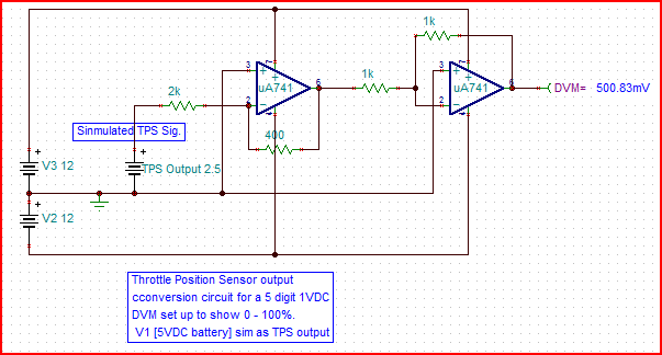

Here's an analog OpAmp circuit for converting the output of the TPS to a 0-1.00 VDC signal, emulating a 0-100% position. Note that it's currently showing a half-throttle (2.5VDC) TPS signal. The circuit is linear.
No doubt there's a simpler/better/more accurate analog circuit but it'll give you an idea of a way to accomplish your goal.
The DVM= value is what would be displayed (probably without the ".83" portion) by the little voltmeter MikeMI suggested.
If this concept doesn't suit, you'll have to go the digital (microprocessor) route.

I also left out of the circuit any calibration pots which, of course, would be needed to tweak the calibration of the gains of both OpAmps.
