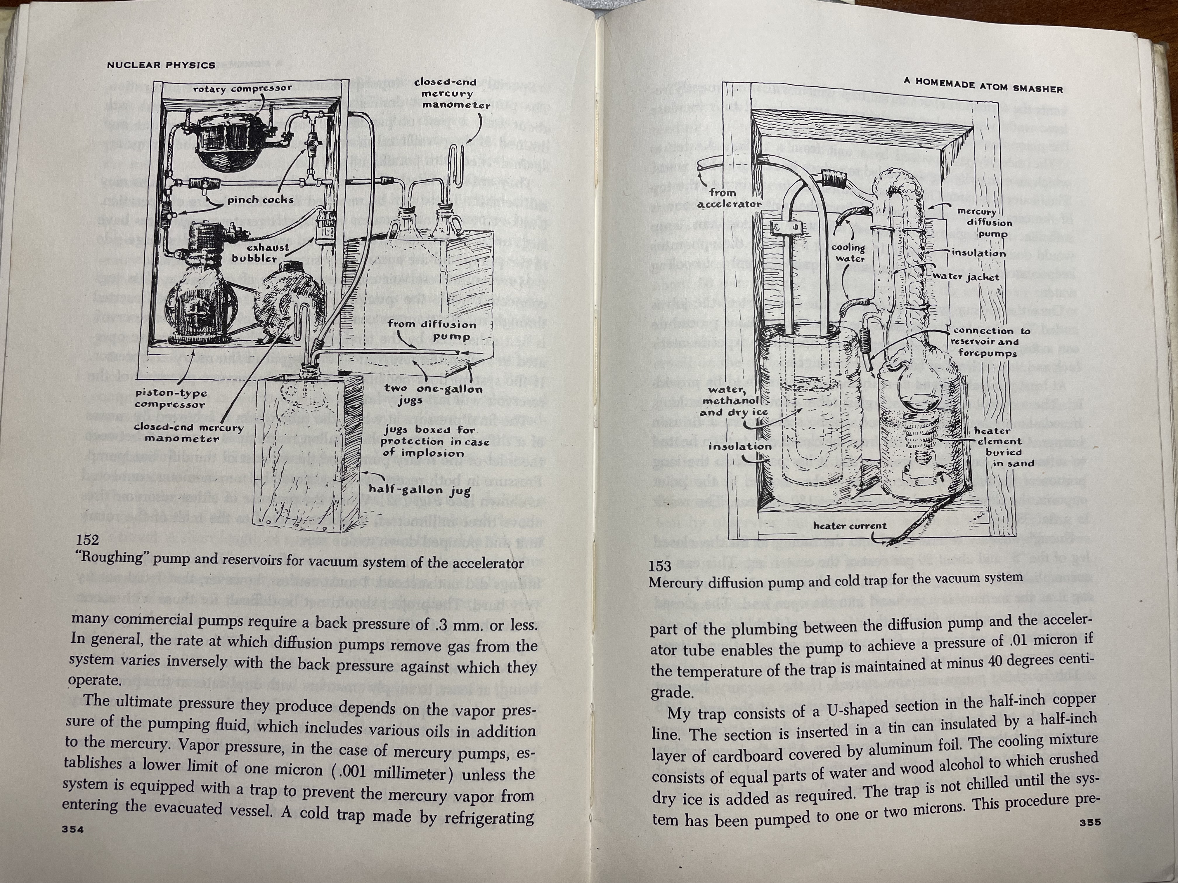

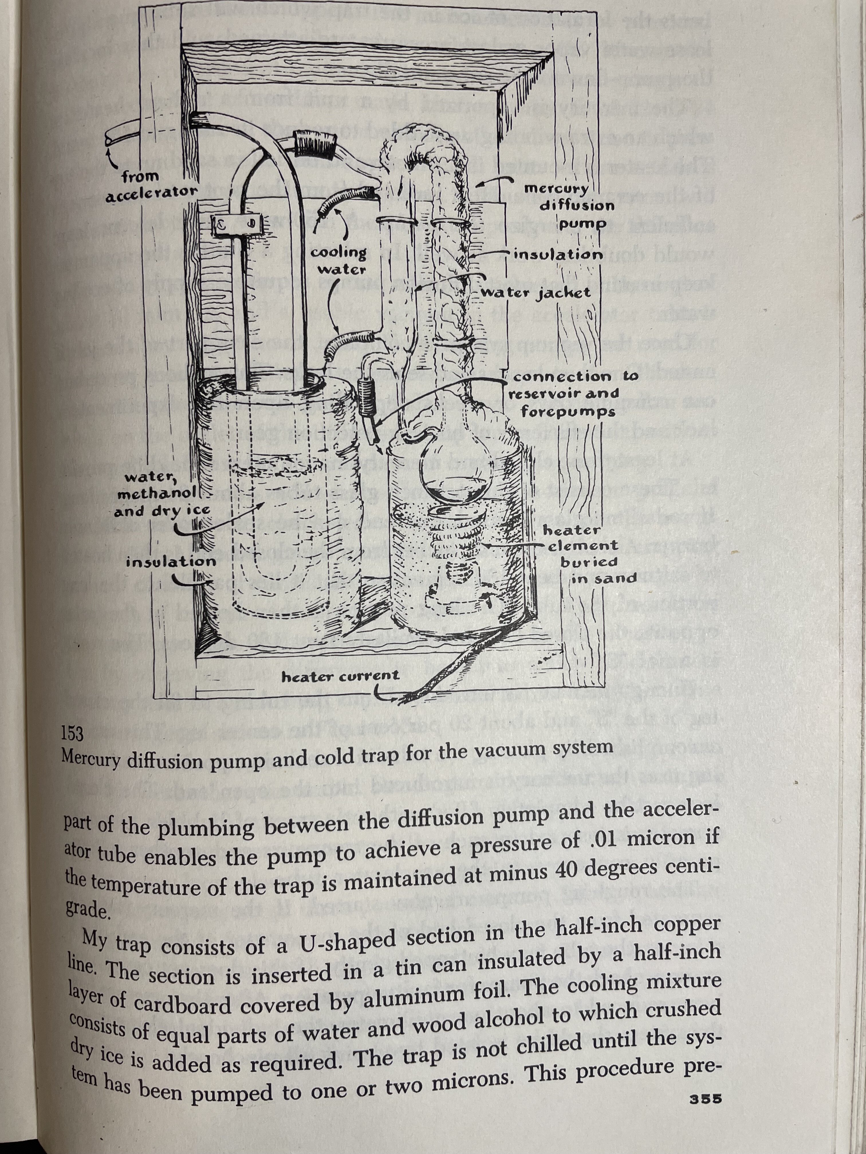

Hi Ray,
if you have learned to blow and form glass, you could make a diffusion pump that will give seriously good vacuum over a few hours.
This is a DIY setup from a 1960s book I have (a collection of 50s Scientific American projects), suitable for getting down to valve/electron tube type levels:
[It finishes with warnings of the possibly implosion hazards when using large glass containers as vacuum reservoirs and that the must be enclosed for safety, and not rapidly allowing air back in as can hammer the mercury or diffusion oil against the inside of the glass and break it, plus mercury hazards etc.]

This is great thanks for finding this article, I've been using an old ac compressor a a vacuum pump.

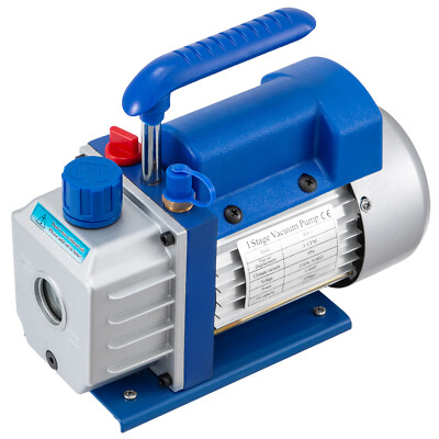

You probably need a better main vacuum pump as well then; the article says most AC compressors cannot pull a really good vacuum due to the type of valves used.
You can get pretty decent ones sold for air conditioning use at reasonable prices - AC & refrigeration systems need vacuuming to remove all air and water vapour before the refrigerant gas is introduced.
eg. First one I found on ebay.
