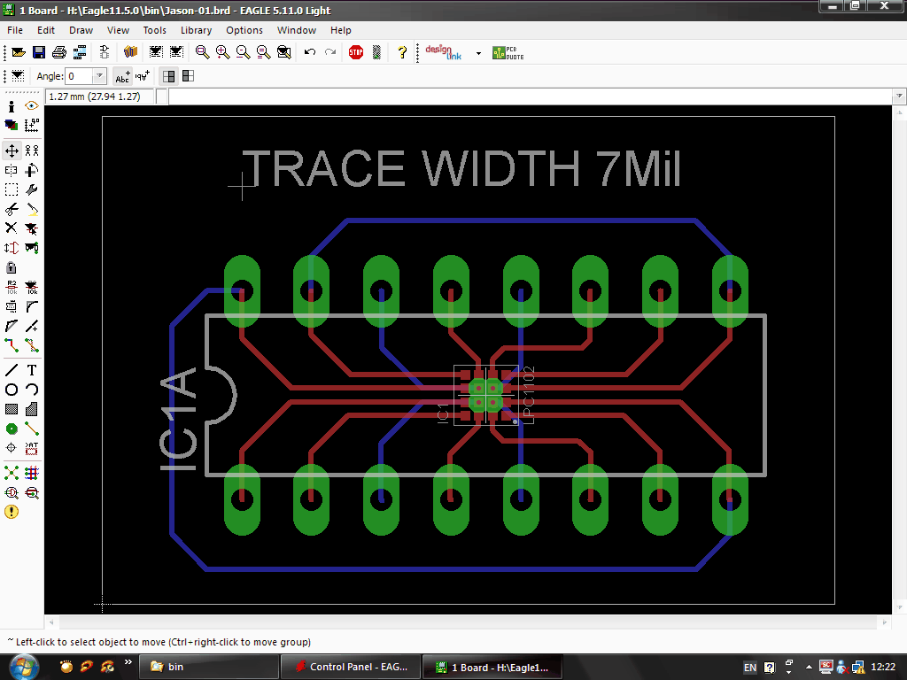

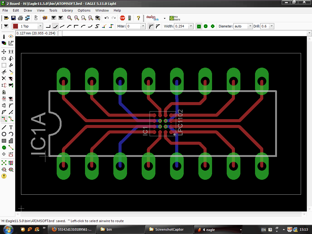

I already made a eagle file for it. The issue is the balls (heh balls) are 0.5mm apart and are .32mm Round so there is hardly any space to place a trace between them. about .18mm (0.007" (7mil)) space in between meaning the trace has to be at least half that about 3.5MIL in order to fit it between the balls. The Service cost to much to make a PCB for that. Unless im wrong. If you use eagle i can send you my lib if you want

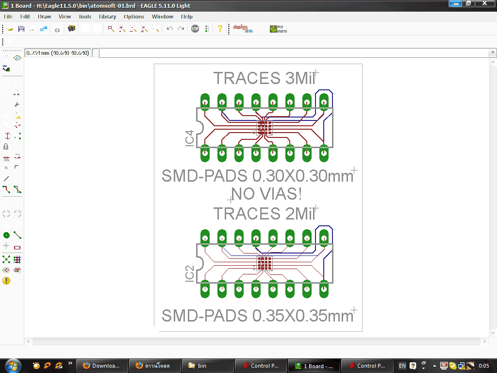

Hi Jason,
first off, the data sheet of the LPC1102 indicates SMD pads at 0.35mm (not 0.32mm).
If the pads are sized down to 0.3mm there is still enough area for safe soldering.
I made a total of three designs and you might pick the one which suits best.
I'd prefer solution three with vias directly on the top pads B2, B3, C2 and C3. Your board manufacturer should be able to drill holes of 0.2mm.
The solder pads (vias) look somewhat strange to me. The package outline shows their diameter matching the SMD pad diameter.
I guess getting the package displayed correctly is a matter of "restring". I do not intend to dig into that since I'm normally using Eagle version 3.55 which displays things in real size.
Please check and if you want my library please give me a note.
Regards
Boncuk

These are the rules:
6 mil trace width
6 mil spacing
15 mil clearances from traces to the edge of the board
13 mil minimum drill size.
7 mil minimum annular ring

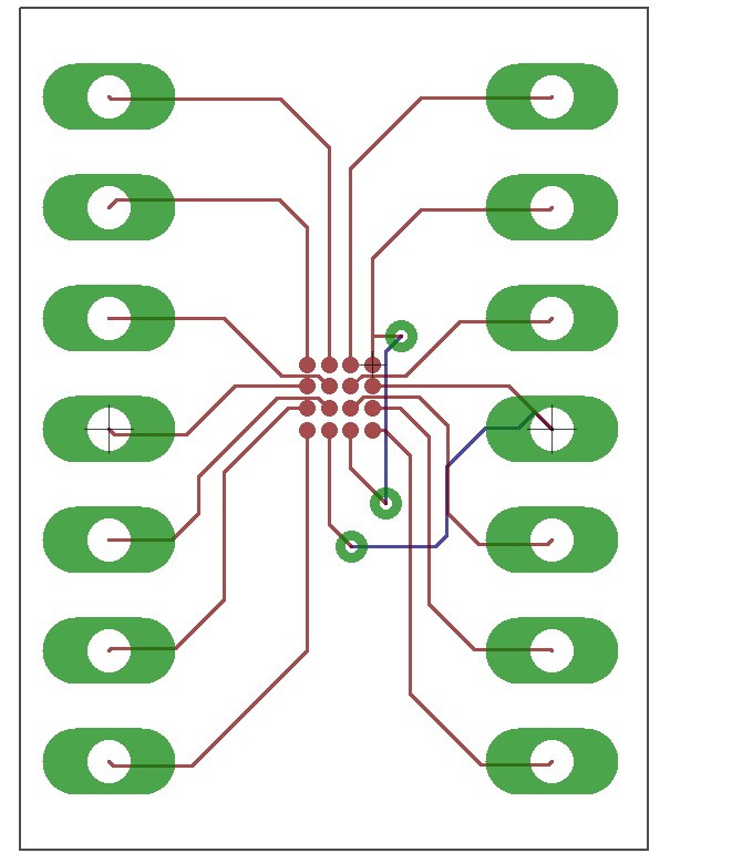

Hi Jason,
the required drill size will be a problem. Your PCB manufacturer has a good opportunity to improve production using laser for drilling.
I managed to get the SMD pads circle shaped and adapt the vias accordingly.
These are the paramters used for pads and vias:
SMD pad: dia 13mils, roundness 100%
Vias: dia 13mils, shape round, drill size 9mils (uncheck Thermal, Stop and First)
The drill size however is 8mils. Trace width for all traces is 10mils.
Connections between pins on the adapter are omitted.
If you get the adapter board made make sure to fill the vias with solder tin up to the top.
BGA components are delivered with tiny solder balls on the pads. If the solder is soaked by the drill hole of the via there will be a poor connection of the solder pads between IC and PCB.
Please PM me your email address.
Regards
Boncuk
