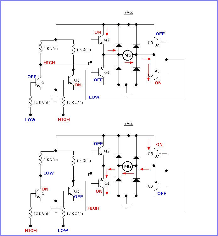

When Q1 turns on, it will turn on Q4. If the load is a DC motor then its "stalled" current will try to flow until it gets up to speed.
Q2 works similarly with Q6.
If an input is low then Q3 or Q5 is turned on, but not very well.

This is a graphic respresentation of how the circuit works. Red arrows indicate current direction.

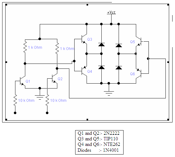

the problem that i am facing right now is that, i couldnt find the transistor NTE262 and TIP110, are there any other transistor that i can use.
what i have to do is that i have to take a voice signal which is processed using the voice recognition tools and if the right voice is there, then to run the motor to open the door or close.
so r there any other transistor that can help me.
also i have attached on the jpg format hope that this wont create any problem viewing.
thanks for any reply
You need to find and replace them with transistors of similar or higher voltage, current and gain.
For your circuit, the original transistors have the following characteristic:
Both are TO220 darlington transistor
NTE262: PNP, 100V, 4A, 65W, hfe=2500 at 4A
TIP110: NPN, 60V, 2A, 50W, hfe>1000
The data of most transistors are available on the web so you can look up the data on whatever transistors are available in your local shop before buying them.

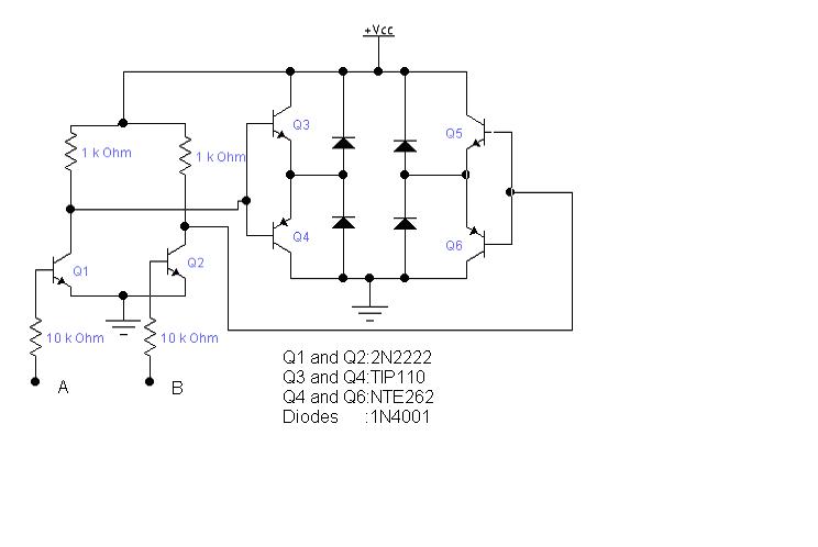

but my mentor told me to use 2 555 timer at the output of the h-bridge and then to connect to the motor.
since i dont see any logic behind using the 555 timer at the output.
so is it good to use the 555 timer at the output of the h bridge to control the movement of the motor. if it can be use they can any one tell me about the why and how can they be used
in the h-bridge.
Perhaps your mentor has good reasons to do so. But there is only one way to find out.
You can print out the GIF I posted and bring it along to the mentor. The GIF also showed the connection for the motor.
Ask him why he would consider the circuit is not adaquate enough to drive a motor and why using two 555s would be better. Ask him for the reasons and satisfy yourself that his reasons are good. I would like to hear them too.

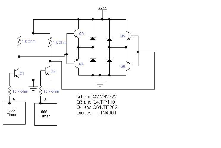

well the actual thing was that my mentor wants to connect the 555 timer at the input of h-bridge that is at piont at A & B, n he told that by doing so the performance of the H-bridge can be increased.
so what u guys think about it

I dont like, you cannot ensure that the two 555 timers are syncronised.
adminidly with this design you cannot get shoot-throughs (be it demanded or switching).
However, doesn't the 555 have an inverted output? - not to sure years since I used one.
If it doesn't use the 555 (a good way to generate PWM) and then via an inverter chip/gate pass the output though the inverter.
You now have a NON-INVERTED and INVERTED PWM, feed these two signals into each input will do the job

Using two 555's like that is a complete receipe for disaster! - it's bound to turn all four transistors on at the same time, blowing all four transistors, and possibly causing other damage as well (depending on the supply).
I can't believe anyone would tell you to do it that way!, perhaps you misunderstood?.

Yes using two 555 is a very bad idea, but as I stated, this topology is the safest one for it to accedently done two.
The phase-legs are in a PUSH-PULL configuration, thus only one transistor per leg will be on => no problem.
IF one input LOW and other HIGH => normal operation
IF both inputs LOW => both upper PNP will be ON, this provides a zero-voltage loop around the top
IF both inputs are HIGH => both lower NPN will be NO, this provides a zero-voltage loop around the bottom
uncle_sam:
What I mean is take a 555 as the source of your PWM.
Now the H-bridge takes two inputs (as you can see), these inputs should be the complement (ie inverse) or each other. IF they are not you end up with the zero-loop configuration I just mentioned. This isnt bad and in some cases extreamly beneficial.
Anyway so you need an inverted PWM signal? Use an inverter/NOT gate.
so you have one PWM from the 555, feed it into the NOT gate and you end up with !PWM.
feed the !PWM into one input and PWM into the other input and it will work fine

Sorry, I didn't realise the H-bridge was as horrible as it is :lol:
It's going to lose a LOT of voltage to the motor in that configuration.
I would suggest connecting point B to the collector of Q1, and feeding a single 555 in to the base of Q1 (point A). This will give sensible PWM to the H-bridge, but still leave the horrible losses!.
