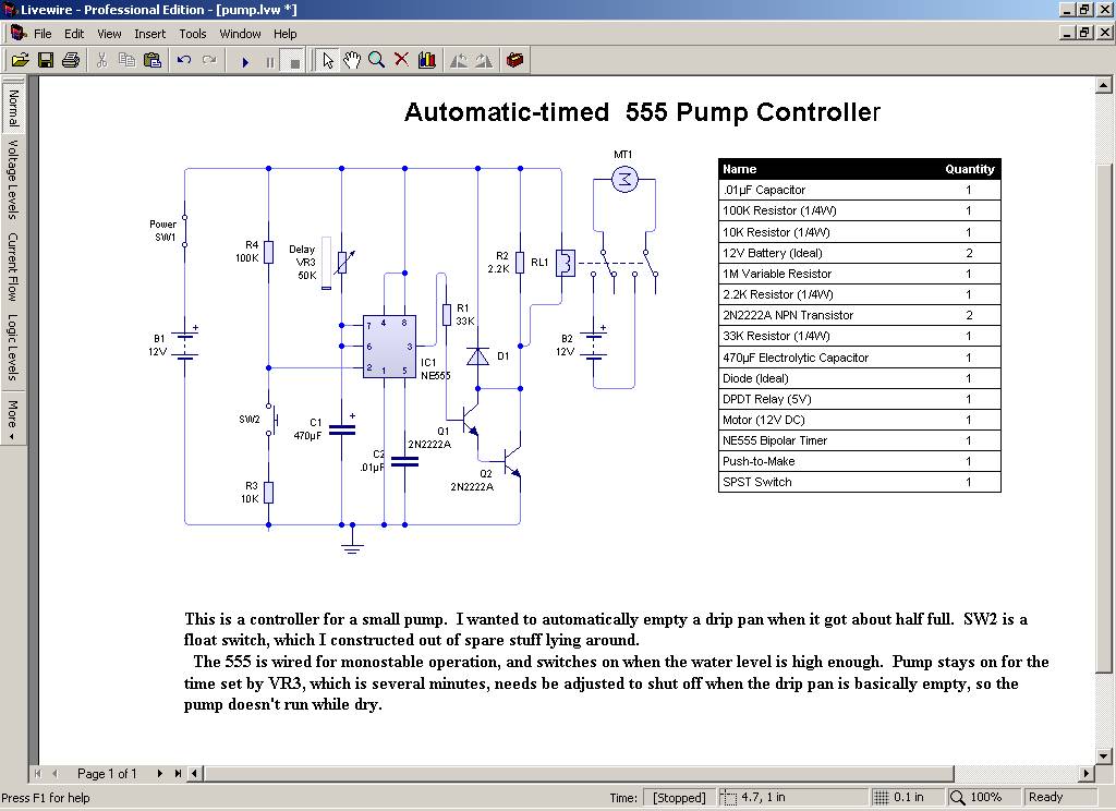

Had a similar problem a couple of years ago, huricane damaged the roof on my florida room. Wasn't a bad leak, but had to keep emptying the bucket. Had a lot to do, and that roof need to wait. Built the attached circuit to control the pump from my old boat. Worked fine, a little glitchy during thunderstorms. Sometimes it would turn on when the power fluxuated, no big deal, its on a timer...
Should note, I ran this off a breadboard, and messed around some trying to smooth out the power flux issue. This is the starting point, you may need to tweak it a little. Probably get a list of improvements from other readers, I'm not an engineer...

Noticed after posting, my attachment didn't take, fix it. Should mention that I used two separate power supplies, the pump I used was high current, figured it would fry the control circuit.

I posted a simple 555 monostable circuit, which I used for a while. I hot glued a hollow plastic ball to the end of a metal rod. Hot glued a scrap of wood to the side of the pan, and the plastic tube from an old pen for the rod to side up and down. Cut the rod of so that it was about three inches short than the pen tube. Mounted a lever microswitch over the tube to trigger the timer.
