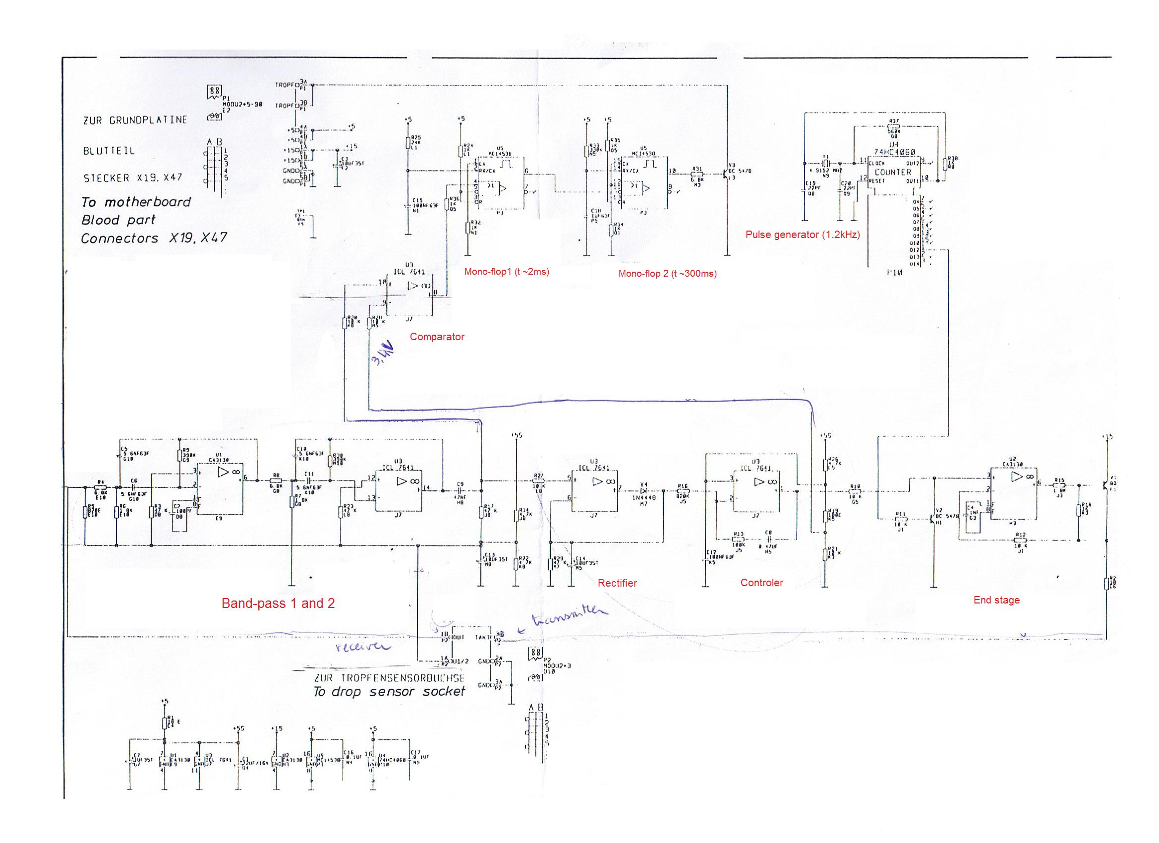

hi guys,
thanks again for your replays,
as Roff did say, the use of a drop sensor is appropriate,

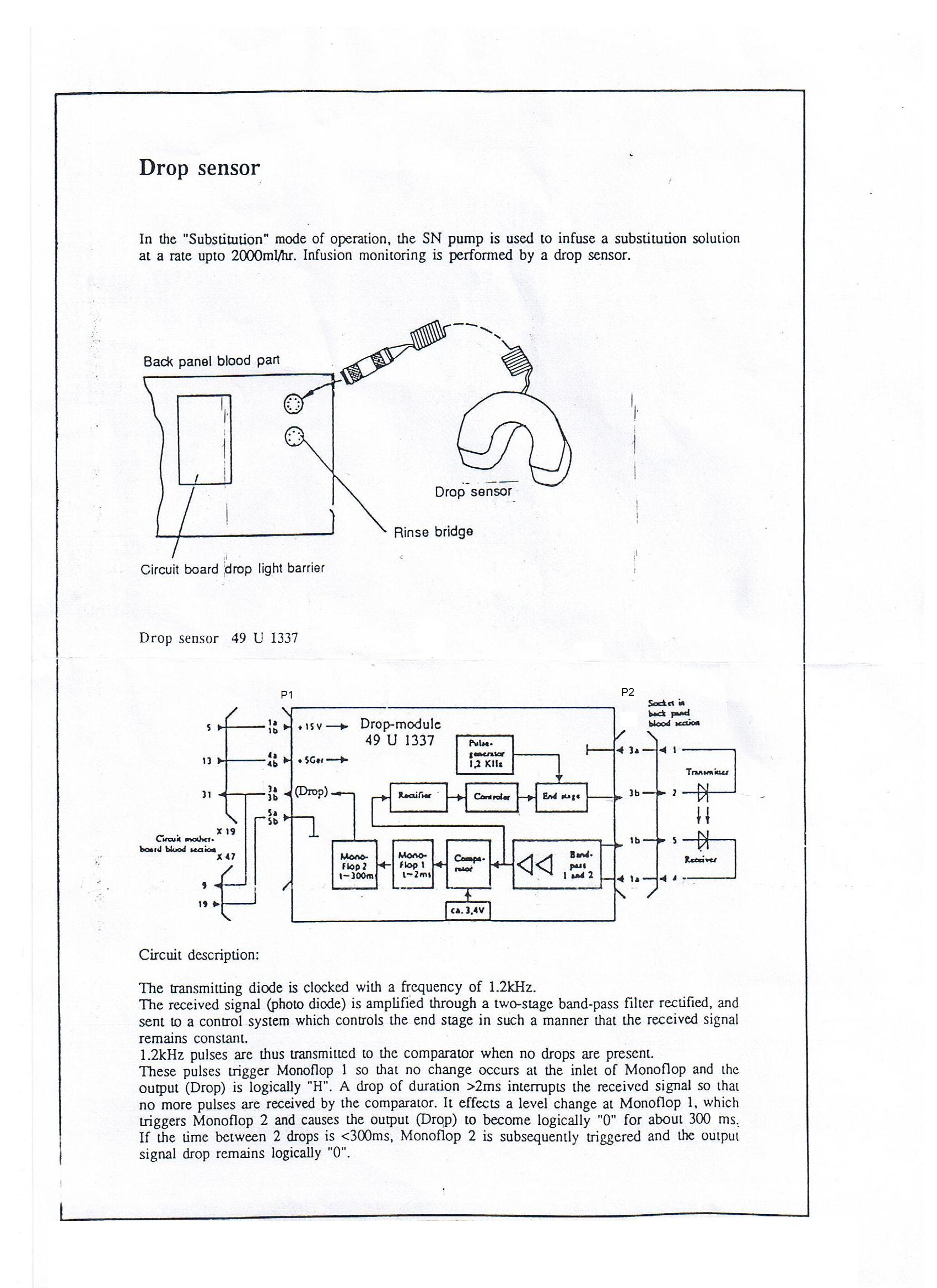

by luck , I've found a schematic of a drop sensor used for a blood pump from early 90's,
it is almost what I'm looking for, I named (in red)the OP Amp in the schematic (as my understanding of the synoptic), and I'ill be pleased if someone verify it with me,
some questions about the schematic came into my mind:
-what is the role of the rectifier.
-why the Pass band filter have two stages ? (is it possible to replace it with just one ?)
-why do the comparator compare the output signal with 3.4V
-I simulate the first stage of the pass band filter using ISIS Vsm and the frequency graph response shown a high attenuation (-60Db), what is the reason ?
-what are the parts of the schematic that we can replace with the PIC.
thanks in advance.

It's difficult to know where to start when describing a feedback loop, but here goes:
The transmitter and receiver are in a feedback loop which forces the amplitude of the bandpass filter (BPF) to be constant amplitude. It does this with a precision rectifier that develops a DC output equal to the peak amplitude of the BPF output. This is applied to the controller op amp, which is configured as an integrator. If the rectifier output exceeds the voltage on the +input of the integrator, the controller output will decrease. A lower controller output causes the transmitter's output level to decrease, which will in turn cause the BPF output to decrease, closing the loop.
The comparator slicing level (3.4V) is set just below the controller reference voltage (+ input), which is, as I said, also the peak amplitude of the BPF output. The comparator will therefore put out a short pulse at each peak of the 1.2kHz modulation signal. Even a small attenuation of the receiver input, caused by a falling drop, will cause a pulse to be missed, triggering the oneshot.
Regarding your simulation, did you apply power (5V) to your op amps?. If not, that is the reason for the attenuation. Otherwise, post the circuit you simulated.
I don't know if you need both stages of the BPF. You could try it with one.
The PIC question would take a long time to answer, at least for me.

That's what I liked about the analog circuit that I analyzed in my previous post. I believe it is very sensitive to small changes in the light path, such as attenuation or diffraction.
