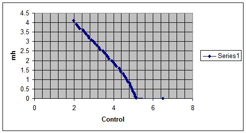

13. Does the saturable reactor (wound inductor with a control winding) need slow-start to avoid voltage spikes?
14. Anything I did or bought was my choice,
15. Presumably as a "Litmus test", an electronic inductor can be quickly created for the two values and the amount of vacuum advance compared to nominal values.
16. Hard part is winding a toroid with that +-30% variqbility.
Attached is a graph showing the linearity over the expected range of L. I don't know fr and I don't know f. I know the control voltage compliance is probbably > 5V. I had a hard drive crash and it was about 7 years ago. I don't know what I have to re-create.
