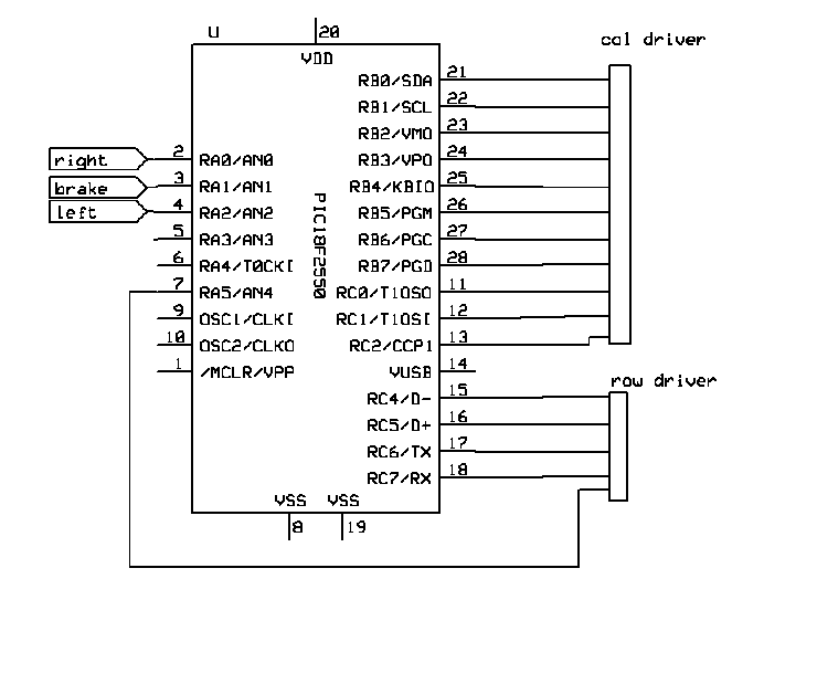

i am trying to make break light system for my bike
i made a 10 x 5 led matrix display using pic18f2550 and 10 bc548 transistor for 10 columns (negative supply) and 5 bc548 and 5 bc557 coupling for 5 rows(positive supply). positive supply is from a lm317 ic its the basic hardware
pic is configured as 16 bit internal oscillator using 1:16 prescaler for better row scanning
actually i made this project for my bike and it is interupt driven and wish to control the brightness via pwm
Say for example,
total 3 interrupts
one for breaklight and other two for turning indicator
when the circuit is powered it is in park light mode that is all leds on with less brightness
on default no power supply given to circuit and working is given as follows
when park switch is on only power supply goes to circuit without any interrupts and it is in low brightness mode
on break signal power supply and respective interrupt is gone to circuit and same for turning signal
but the timer0 interupt not working
pls help me to blink an led using these config then i can do rest

Here a little sch to start with I need to see your led hookup. anode + and cathnode-
