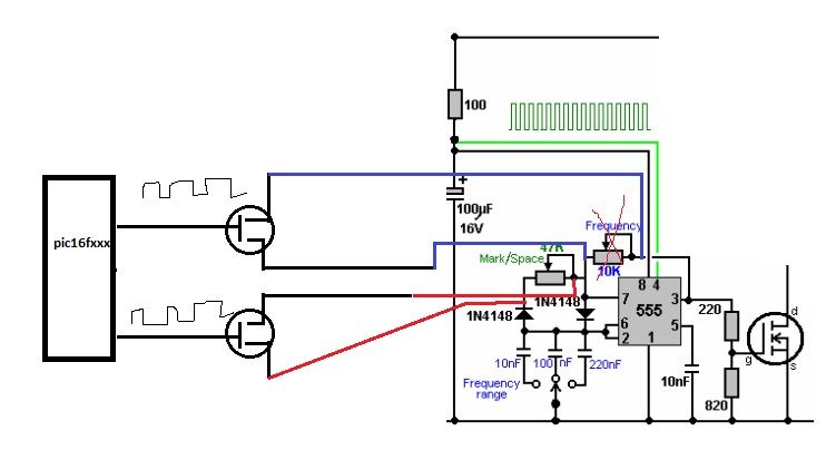

Would something like this work? Sorry for the sloppy diagram but I was thinking maybe instead of the pots there I could control the frequency and mark/space (duty cycle) by using a FET driven by the PWM module on the PIC. This way I could vary the charging rate of the capacitors? Would this work?

If you wanted to do it that way I would just use a digital pot.
Programing them just takes a couple of lines from the PIC and they cost no more than a standard manual one.
Trying to use fets to replace the pots is very tricky and time consuming to get them to bias properly.
What kind of resolution (steps) do need?
Here is a good example of how to setup the TL494 and it is possible to use the FET method to control it is parameters because the FET's would be referenced to ground.
jer :)
