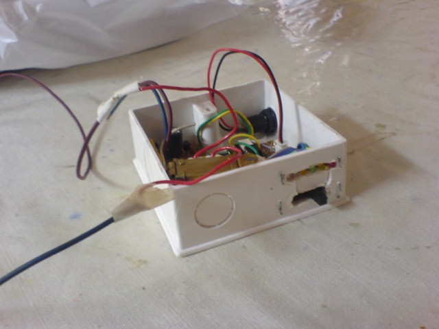

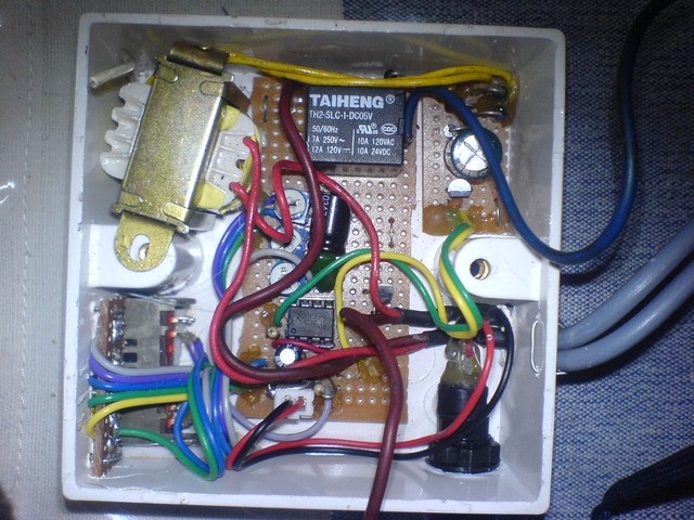

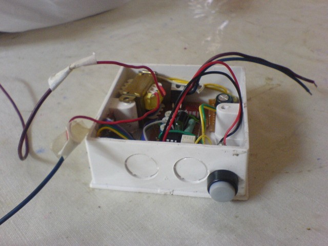

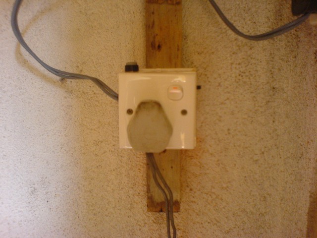

Hi all,
Just found out that the water pump was 4.1A rating pump [0.75hp,4.1A,0.56W,220v] connected to 15A line.(took lot of time to find the pump box.) so i was able to use a small relay,(small enough to fit there,but had to cross 125km to find it :p).as first I couldn't find the pump details,initially i assumed it draws all 15A when operating and try to find a relay that can handle 15A.but now as it becomes 4.1A,I used a small 7A relay.It worked then had a problem of self triggering timer when relay turns off, and After adding some capacitors and diodes that problem was solved, and i have fixed it in a box and fixed it to the wall.
It works nicely now:) (I guess);) we will see how it perform in future)
So I want to thank everyone who helped me with this
THANK YOU

Post a schematic to be sure you have the relay connected right.
Just because it works does not guarantee it will continue to work.
A diode across the relay coil
A capacitor across the relay contacts to reduce arcing.
Etc etc
Glad you got it working
How much space is there between the mains and DC tracks on the board?
There should be clearance of at least 7mm.
Have you connected a snubber network across the relay contacts? If not connect 100nF and 100R in series across the contacts.
A resistor with the same value as the relay's coil connected in series with the back EMF suppression diode will also help to prolong the contacts life.
