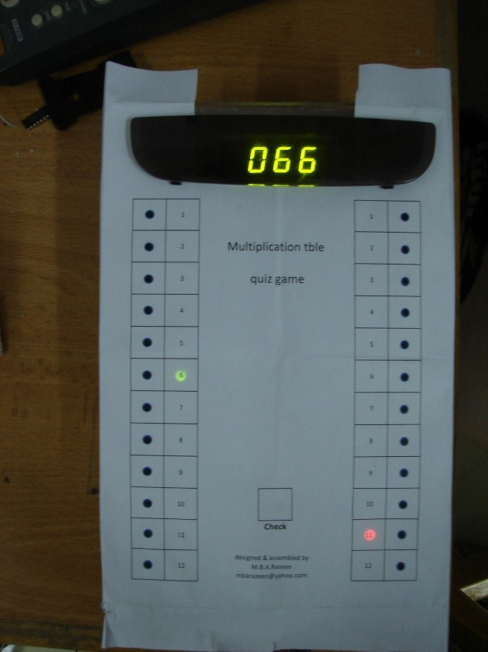

I did a project for my daughter using basic logics and counter to multiply two numbers maximum 12x12. select two numbers to be multiplied using two keypads one on left and one on right, then press the check button, the result will be displayed. Your task is to add two numbers and can be done easily. select 1st number and 2nd number, use a clock to count the total and hold.
Our task? Or is it your task, in which case this looks a lot like homework and not like a project for your daughter.
Home work? I spent nearly 5 days soldering around 40 ICs.
Sorry looks like I completely misunderstood what your post was about.
