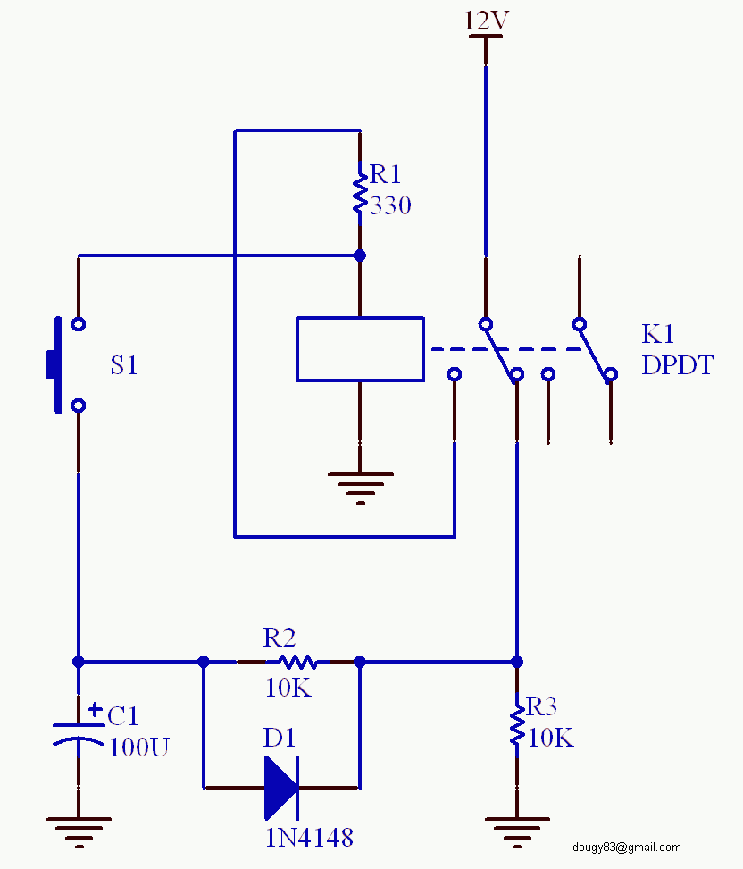

What about a little relay logic? Have a look at the attached circuit. It works (I hope it works) with a clean switch contact; if you only have the switched 5V signal, then use an additional 5V relay to provide the clean switch contact.
What about a little relay logic?...
That presumes that he has a spare set of switch contacts that are not already being used to switch something else. That is not the impression I got...
Ya... the switch i'm required to use is already in place and thats half the problem. Its a two pole switch that when pressed makes contact between the sig wires and tells the controler that the button has been pushed. It may be easier to just swap the operating voltage to 12v so that i don't get any odd side effects from the controller.
Now i liked Mike2545's idea... i'm not 100% sure how i would have to wire in the entire thing and if it would work for a 12v line as well.

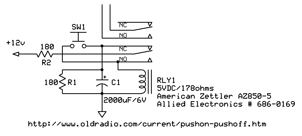

Here is a unique little 12v push-on/push-off relay circuit that might work for you.
Ken
