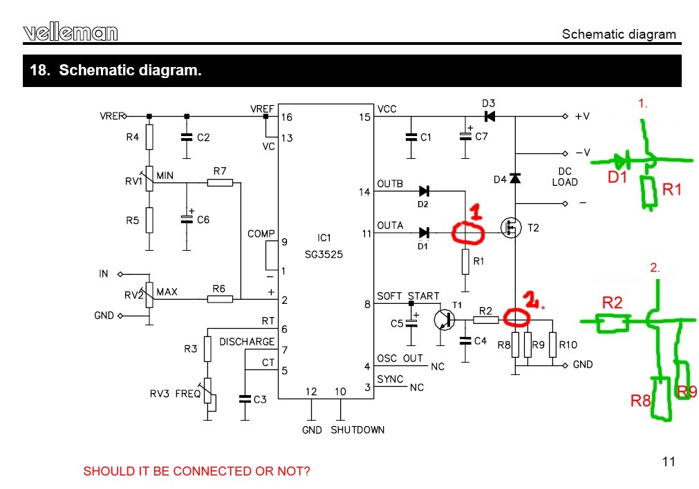

I'm also puzzled with connections, I attach the diagram from manufacturer PDF file. The areas I do not understand are in red circle.

My guess is those connections should not be made. You would expect a "dot" to show that. They have a square dot at some points where three wires meet, not at others.

I installed BUK555 and connected low power 5w halogen lamp. Everything works except I can't adjust the output brightness. The voltage changes between GND and IN ports when I turn the 1K ohm POT but output voltage on LOAD ports does not change.
Tried to adjust RV1,2,3 no change. Is there some reference point I could check in this situation to find a faulty part etc. I connected everything like in diagram on PDF.

I fixed it, now it works fine :D
Change the BUK555'60 MOSFET to IRL540N (cheaper too) and remove heatsink ground wire.

First, in post #4 (attached schematic) the question was asked if two points should be connected and it seems no one answered... yes, those two connections should be made. The SG3525 is a double ended PWM. The 2 outputs are diode "or'ed" to the gate of the MOSFET to turn it on, but because of the diodes, the PWM can't turn the MOSFET off because the diodes are back biased, so R1 acts as a "pull-down" resistor to pull the gate low during the "off time".
R8, R9 and R10 act as the current sense resistor. During the "on-time" the current will ramp up (E=L*di/dt or (E*dt)/L=di), there will be a voltage developed across the resistors proportional to the current (di). When the voltage gets high enough to turn on T1, it will pull the "soft start" pin low and turn the PWM outputs off. When the voltage across the current sense resitor falls to level where T1 turns off, the PWM will go thru a "normal" soft-start cycle. R2 and C4 are a filter to get rid of the spike that will be there at turn-on. The time constant of R2 & C4 should be made equal to the width of spike. The resistor(s) value (R8, R9, R10) will go down because you want to pass more current before T1 is turned on... just figure out what the peak current will be for your load and size the resistor(s) so that you get ~ .65V across them.
