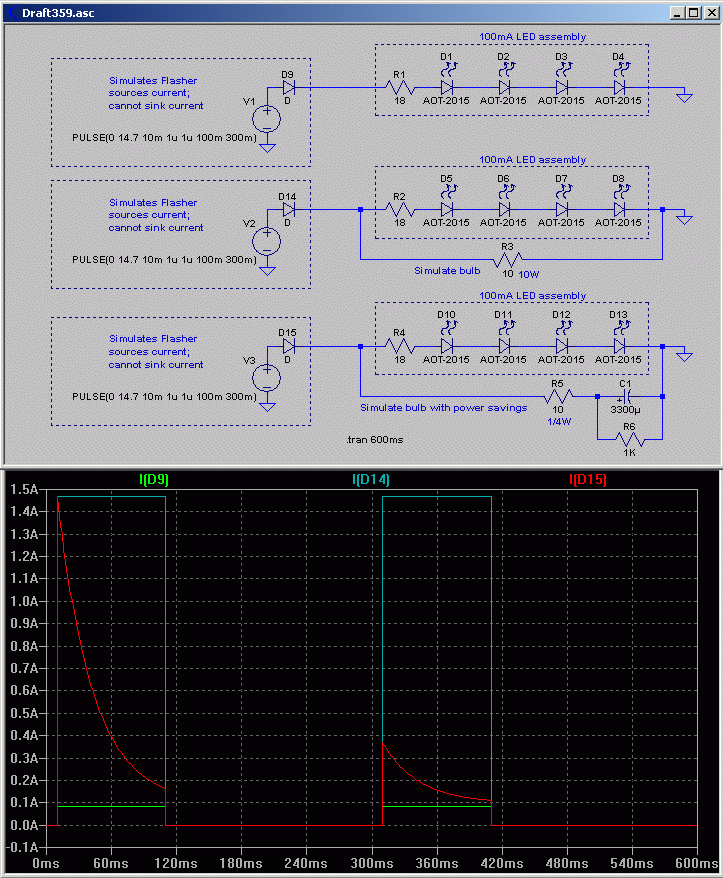

I'm guessing that the original lamp is ~5W, so it would draw I=P/E = 5W/14V = 0.36A. That is a hot resistance of R=E/I = 14V/0.36A = 39Ω. The cold resistance of an incandescent lamp is usually much lower, about 1/3, so ~10Ω.
Likely, the LED assembly operates on less than 100mA, so has an "effective" resistance of 14V/0.1A = 140Ω. You will have to fool the "burn-out" detector into thinking that the LED assembly has a cold resistance of ~10Ω instead of 140Ω. To brute force this with just an external shunt resistor would take a power resistor of 10Ω 10W, or a 4W 14V lamp ;)

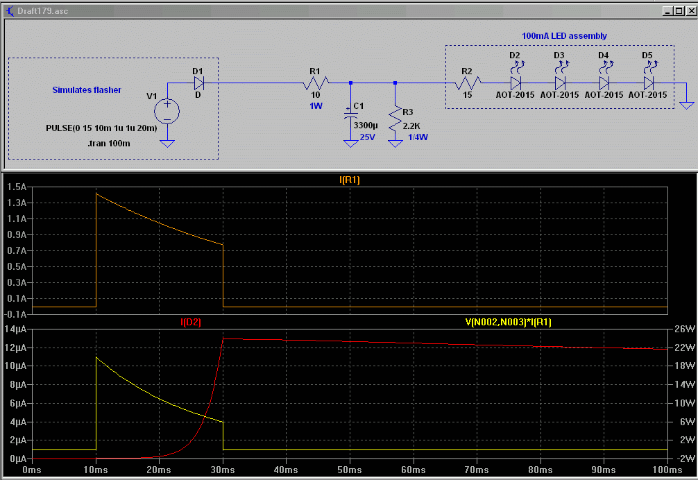

Some power saving could be had with the following circuit:
Can you buy a 3300uF 20V electrolytic cap cheaper than a 10Ω 10W resistor?

I suspect the lamp test is done by applying the testing pulse via a resistor and checing that no significant pulse is seen on the lamp end of the resistor. The OP says that the test does not see the lamps as open circuits. I think MikeMI's bottom schematic in post #11 should work. I also suspect that R5 could be increased in value and the value of the capacitor reduced to save space. The value of the 1K resistor R6 could be increased as the capacitor has about 30 seconds to discharge.

While Mike's circuit nicely fools the bulb-test, how does it stop the LEDs flashing briefly, which is the OP's concern?
Aha! That's why I suggested putting the capacitor after the 18 ohm current limit resistor. For a few milliseconds it keeps the voltage available to the LEDs below (Vf x 4). I guess that to do this the "right" way, split the 18 ohm resistor into two 10 ohm resistors in series and put the capacitor between them to GND. Now the pulse sees 10 ohms per Mike's calc, but the LEDs see are fed through 20 ohms for some power savings.
I forgot about that. Perhaps the TS can do something with this:
Aha! That's why I suggested putting the capacitor after the 18 ohm current limit resistor. ...
Doubtful that the TS can get hold of the node downstream of the current limiter in a sealed LED assembly. Likely, it has just two wires accessible without cutting into it... The circuit of post #17 has only added parts external to the LED assembly.
