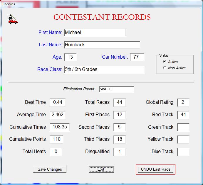

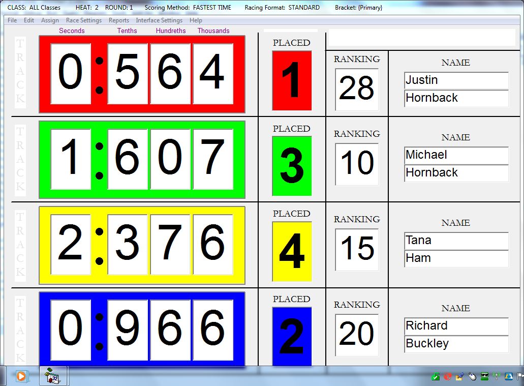

I have developed a software program written in VB6 which will ‘time’ the four race tracks simultaneously. It also tracks and computes all the data that relates to each individual racer throughout the event. My problem is I need someone that can design and build the Interface Board via the actual Race Track sensors and my Program. The race track (used by several children events) is about 30’ long and 16” wide. The cars are driven by gravity force from a slanted track at the beginning. I have to be able to lock-on to their ‘times’ within 1/1000 of a second using four individual timers. I am currently doing this using my program and tracking the times internally (using the computer as the timer) and using the ‘computer screen’ as the timer display. The display runs in Real-time and shows the times counting simultaneously during the race.
I purchased an USB Interface Board with 5 digital inputs that tracks the four individual finish sensors and the starting gate sensor. When I detect one of the finish track sensors via the interface board, I then stop that particular timer. When all four sensors have been tripped then the race is over for that heat. All worked well and I was able to track the events. But I have a serious problem! The Interface Board is too slow to respond in a timely manner. If the interface board is off-line and I use the keyboard to simulate my finish sensors, then all is fine, But once I put the interface board on-line, my counting sequence degrades dramatically to unrealistic results. The reason this is happening is because my program has to poll the board every 1/1000 of a second. The board simply can’t respond that fast which causes a ‘second’ to become more like ‘8 seconds’ in effect (the computer is waiting on the results from the board). If I set the program to poll the board every 1/100 of a second, the timing is more (but not great) effective, but the accuracy is severely impaired. If 2 cars trip their finish sensors within that same 1/100 of a second (very possible), then all information is lost on one of the two cars. Totally unacceptable as you can see.
The only work-around that I see is that the Interface Board itself has to track the four times individually and when these times are latched by their sensors (finish), the board then triggers an ‘event’ to my program. My program then reads these times and takes over from there. I don’t have enough knowledge to build something like this and I believe the board itself will have to have some ‘firmware’ attached to it also. The event (or firmware) has to be able to be read by VB6 program. VB6 is somewhat limited on catching external events. In other wards, instead of my program polling the board every 1/1000 of a second, I need the interface board to initiate a request to my program when an event takes place. I don’t know if the board can do this with one timer or if there needs to be 4 separate timers.
Please look at the attached pictures that I have included. Even though the board would actually track all the times, I would still like to be able to show the times on my computer screen counting in real-time if possible. If not feasible then I could simulate my own counting process for visual effects only, but use the ‘Real Times’ read from the Interface Board.
