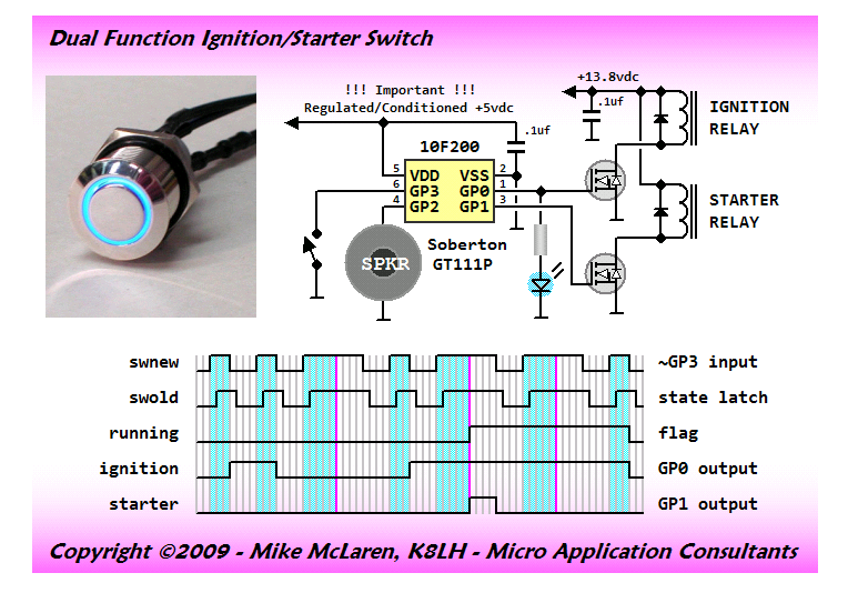

I'll bet that a dirt-simple 8 pin Pic like this one will be the most cost effective. By the time you de-bounce the switch, find a capacitor that has sufficiently low leakage to make a 90min timer, wire up a dozen other parts, how can you compete?
I agree too guys. The 10F200 in an 8-pin DIP package is only 55 cents at Mouser; PIC10F200-I/P Microchip Technology Microcontrollers (MCU)
If this is a "one off" application I'm sure someone on the Forum could help by writing the program in about 30 minutes. If you add location info' to your profile someone in your area might consider burning the program into the PIC for you. If this is a commercial application then you might consider paying for the code or offering royalties.

ignition-10f200-png.37282

You would not need R/C parts to create a timer. There's a built-in 4-MHz oscillator (1% accuracy) time base that you use to derive whatever frequencies you need. Depending on what you're doin' with the '4093 you can probably create the same logic in software in the PIC program.
