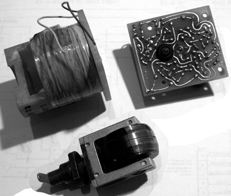

Hello, this is my first post on the forum. Sorry it's so long!

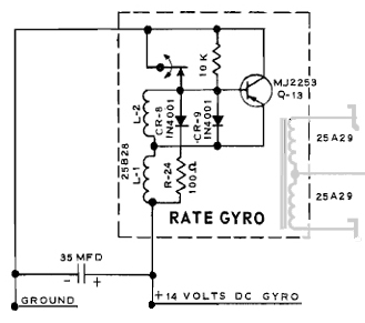

I need some help to better understand the circuit shown below. This circuit shown is only a portion of the entire schematic for the device.
This circuit drives a gimble mounted rotor (Gyroscope) in a coil wrapped cylindrical housing via an optical sensor located on the PCB attached to the open end of the housing. (See photo below)
I'm pretty sure the optical sensor is depicted by the "curved double-headed arrow" in the upper left of the schematic. If I am correct, the sensor is essentially a switch that opens and closes as it "sees" the "dark and light" hemispheres of the rotor going by. Does this make sense? If so, can anyone explain the current path through the circuit as the "switch" opens and closes?
Also... Is the coil simply turned on and off or does the circuit actually reverse the bias of the coil as the "switch" opens and closes? I am puzzled as "physically" there is only one coil with only two leads (see photo) whereas the schematic shows two coils (L1 & L2) with three connections. I'm guessing the real coil is represented in the schematic as L1 & L2 combined; Or, L1 and L2 each represent the same coil in different states. Can anyone clear this up.
Lastly... Currently, when power is applied to the circuit, the rotor starts to turn but only turns one half of a complete revolution and then stops. So whatever is suppossed to change the bias of the coil is not working. I have tested the optical sensor with the PCB disconnected by applying 14V to the input of the board and then, while alternately lighting and shading the sensor, measured the board's output to the coil. In this test, the output to the coil starts at about 6V and drops to zero (or close to zero) as the sensor is lit or shaded. So I am pretty confident the sensor is working as it should. What other components in the circuit shown, if failed, might likely cause this behavior?
Any assistance will be much appreciated.

From the back of that circuit board, it appears to contain more components than your schematic shows.
I should have mentioned...

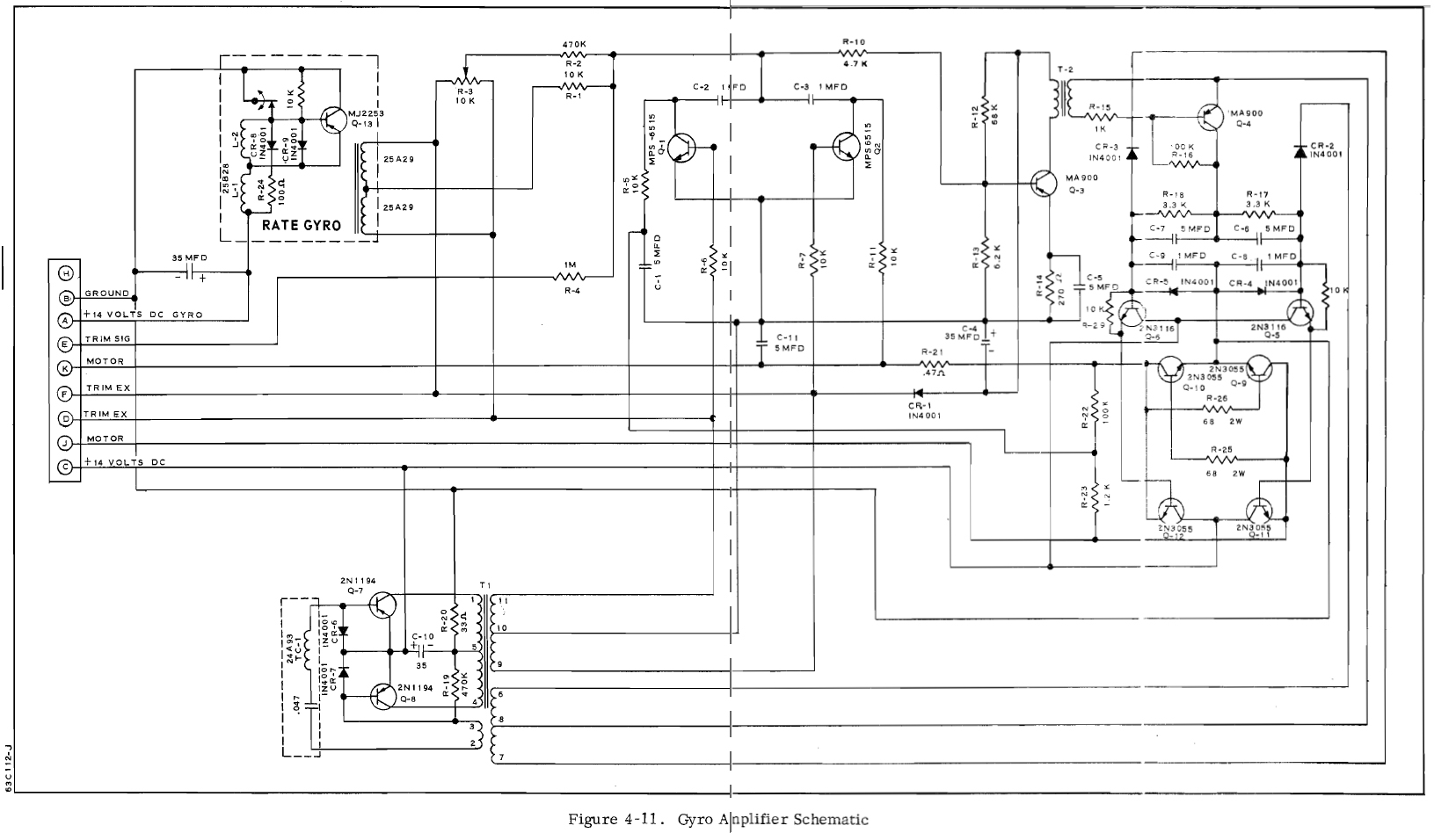

A copy large enough to read will probably be too big to fit in the body of this post so I'll upload a larger version for you to click on. Thanks for your help!
I look forward to any or all replies. ZT
*sigh* Just as I suspected - you don't have the right schematic.
But you knew that, didn't you? That's why you went through all this BS instead of posting the rest of your schematic. That's why you still have not posted a pic of the top of the board.

For example, the photo below shows a slightly different version of the gyro mounted circuit board shown above. Same part number but apparently a slightly different revision. While the above circuit board has a miniature lamp to help illuminate what the optical sensor sees, the version of the same board below omits the light bulb and uses a slightly different sensor.
Other variations, I've found, are the result of some of the older style semiconductors and paper capacitors that were in these old boxes, being replaced in the field with more recent and more reliable components.
So why am I posting all this? It would be easy to say it's because I still need help with the electronics but frankly that's no more important to me at this point than letting you know that I resent your demeaning attitude and your unfounded allegations that I have somehow been deliberately deceptive and less than forthcoming in this thread. THAT"S BS and I assure you it is not the case! Now, to be fair to you, it may be that you haven't yet realized that this little circuit board is only a small portion of the entire circuitry and the bulk of the components shown on the schematic are located on another circuit board. But hey! How would you know? Since I didn't mention that either. Perhaps the following pictures will help you step back and pull your head out where it seems to be stuck. I'm trying to be nice here!
From the service manual...
And a couple of the GyroAmps I have for parts...
And the one I'm working on with the cover removed...
And two close-up views of the GyroAmp Assembly for a better look...
Here you can see (in the photo on the right) the small inductor coils that Iwere grayed out on my original "incomplete schematic" because I believed they were not relevant to spinning the gyro but rather related to gyro output signals. You may also be able spot the four exterior power transistors that are shown in the right hand - lower center of the schematic, and the brown adjusting wheel of the 10K pot that is used for system centering adjustments (upper left of the left hand photo). You may even recognize what constitutes the mixer amp and oscillator sections on the large circuit board though I sure can't at this stage of the game. The point is, and again I could be wrong, that much of the full schematic, (perhaps with the exception of the oscillator section), is unrelated to the spinning of the gyro and more to do with the proper output signals to a servo motor. Please try to keep in mind that I am only trying to get the gyro to spin at this time.

As far as the principle of operation of the rotor ....what makes it rotate ....I am guessing that the inductors L-1 and L-2 generate a time-varying, or increasing magnetic flux vector, when the switch is closed. Then, when the switch is open, the PNP transistor is turned on and the flux vector in L-2 is reversed, and cancels out the flux vector of L-1, for a half cycle or until the switch is closed again.
The resultant waveform for the overall flux vector within the coil assembly would then be some sort of sawtooth, or possibly an asymmetric triangular form.
If you have a list of the parts and their values, it would be of interest to know the specification values for L-1 and L-2. ... I would guess that L-2 has twice the value of L-1. ....
As far as getting the rotor to spin, the PNP transistor could be defective, or one of the diodes connected to its base might be shorted. You have said that you checked the opto-switch. It might be beneficial to confirm that it does conduct current .... without excessive resistance. ....
What do you think about de-soldering the PNP transistor, and checking it with a transistor tester? I think that I would want to make sure that the opto switch is working properly ....actually conducting current and switching states...
Another thought .... electrolytic capacitors ... i.e. the 35 µF part, are known to age and fail after some years of use. Can you de-solder that part, and check it with a capacitor tester?
NOW we're getting somewhere.
The motor coil looks like it's going to be driven off those 2N3055's, which are hooked in an "H-bridge" configuration, and THAT will reverse the polarity to the coil. (your original circuit was part of something completely different, I believe you will find it connected to one of those little transformers on the side)
The 2N3055 (the big transistors bolted to the case) is a fairly old bipolar that blows out a lot. It will often (especially in older equipment) simply have a corroded transistor socket or contact - I can see rust on the transistors themselves, good chance simple corrosion is causing the problem. A bad transistor or socket in the H-bridge can stop the reverse polarity, so this is a good starting point to work from if the motor coil isn't reversing. Do you know how to check a bipolar transistor with a meter?
Thanks for your reply Duffy! And YES this IS more like it!
I don't know if it's the best way but I have checked the 2N3055's with a DMM on the Diode Setting. Then checking the resistance across each of the E-B-C junctions in both directions. Then comparing my readings to a chart I dug up that specifies Hi Resistance (open) and Low Resistance (an ohm or so) for each junction on a good PNP or NPN transistors. Using this method I found two of the transistors (Q-9 & Q-10) were bad. I replaced all four of them last evening and had high hopes for my next gyro function test after finding and replacing the little 6v lamp beside the sensor. (I'm using the green circuit board for now). Same bad results! The rotor turned 1/2 of a revolution and then stopped abruptly with each application of power.
I'm now thinking I should probably check at least Q-9 & Q-10 again thinking whatever took them out might have killed the new ones too!
While there was some corrosion on the transistors the case looked pretty clean underneath them. I simply reused the old thin plastic base "insulator gaskets" under the new transistors. Should I be using some sort of insulating grease instead or in addition to the "gaskets"?
I do appreciate your help! ZT

Rotor Rotation ...
The rotor rotation is caused by a changing magnetic flux vector in the main L-1 and L-2 coils. These coils are the large wire coils that appear in your very first post. They would be wrapped co-axially around the outside of the rotor housing. There must be 3 leads coming from the two coils .... one from each end, and one center tap connection.
If you have only two leads, then one lead has broken off ... probably where you can't see it.
The current direction in coil L-1 would not change in direction. The current in L-2 would be the same as in L-1 for half a rotation cycle, and then would change or reverse direction for the other half cycle ... or switch position.
The notation of the switch on the first diagram that you posted does not give any indication that it is optical in nature. It just shows an open and close position, and might have been a mechanical switch of some sort in an earlier version of the gyro.
I am trying to determine which transistor in your photographs is Q-13 ... that is the MJ2253 PNP transistor. According to the available data sheets, it should be a relatively large TO-66 case .... roughly 1" long and 1/2" wide. .... probably mounted on the outside of the frame.
The motor coil looks like it's going to be driven off those 2N3055's, which are hooked in an "H-bridge" configuration, and THAT will reverse the polarity to the coil. (your original circuit was part of something completely different, I believe you will find it connected to one of those little transformers on the side)...QUOTE]

Hi 88,
Thanks again for your reply. Much of my confusion comes from the pondering of whether L-1 and L-2 are in fact the gyro housing coil. The third lead problem has kept me stumped. There is only two leads coming out of coil unless the three coils I've looked at each have had one wire broken off. Three different samples and they all have only two leads. I am ready to accept that L-1 and L-2 do in fact depict the gyro coil winding and that brings me back to my theory that L1 and L2 are depict the one coil in its two different states.
I posted previously that I also found an MJ2253 but like you only in the TO-66 case style. I know what they are (sometimes referred to as Baby TO-3's) and there aren't any in this device. I did de-solder what I thought might be Q-13 to test it from one of the two boards I've been fooling with. It's marked M 639 - 2N5192 and is available in a SOT-32 Case. I will check the data sheets for each and though I'm not sure what all the values mean I should be able to find out if the two devices are electrically the same or similar. I will post again on that with my findings.
Thanks a lot for the great description of the current flow of the little circuit. That helps a lot with my visualization. The only thing I'm not clear on is what exactly depicts the switch. The little lead with the curved arrow running through it or the lille lead with the upward poining arrow? I am howver now quite sure this switch is the fact the opto-sensor.
I appreciate your interest and your assistance and would love to hear your thoughts and opinion on my thinking here. ZT

It sounds like there might be a deviation between the schematic diagram drawings and the as-built circuit boards.
It is something of a mystery as to why you are not showing three individual wire leads coming from the large wire coils that are exterior to the rotor housing.... assumed to be L-1 and L2. What are the yellow and white wires ...4 in all .... that appear in the very last of your photographs? ... I can't tell what they are connected to.
It may be that in a certain production era of electronic parts, the Q-13 transistor, an MJ2253, had a different case style.
It might be interesting to access the appropriate leads to the gyro circuit board .... one being the L-2 coil termination that goes to the switch, the other being the Q-13 emitter terminal .... that's the one with the arrow pointed inward ... and see if you could manually get the rotor to rotate a turn or two .... just by touching the negative capacitor terminal wire between these two points.
