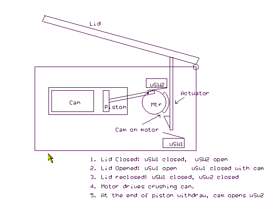

hi Bob,
I would fit a hinged lid to the crusher, either wood or clear ploycarbonate.
Fit a microswitch under the lid.
Lift the lid, trip a mechanical switch latch, place the can inside the crusher,
closing the lid operates the microswitch which powers the motor.
At the end of the withdrawl stroke the mechanism trips the mechanical latch and the motor stops.
Finger safe and low tech.

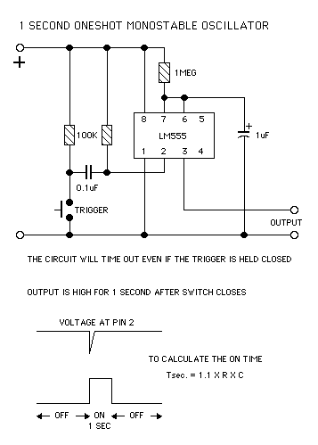

As a little contribution, I suggest you to put 2 metal electrodes inside the chamber, so only a can (and not a hand, wood or other object) could close the circuit and actuate the crusher.
A 555 IC configured on "one shot" mode works as a timer and prevents the same crushed can triggering the crusher again and again if left inside the chamber (one shot per can).
The attached circuit shots a 1 second pulse, but can be modified to fit the time the motor needs to be spinning to sucessfully crush the can
At the pin 3 of the 555 you can connect a NPN transistor, a relay and your motor. I'll make a better schematic for you after dinner
pd: sorry by my english!

Hi Menticol,
the circuit you suggested provides an almost accurate pulse of 1s (1.001)duration replacing the 1M resistor with 910K.
I doubt that the enamel on the cans conducts. (no sample here to prove) So I'd suggest to use an IR-barrier.
Using an IR receiver TSOP1738 and a timer circuit oscillating on 38KHz with two IR-transmitting diodes will do to trigger your suggested one-shot. I simulated it and so far it seems perfect.
The logic will be negative since the timer circuit has to be negative edge triggered. As long as the line-of-sight connection is present the receiver output is high which changes to low if the barrier is interrupted.

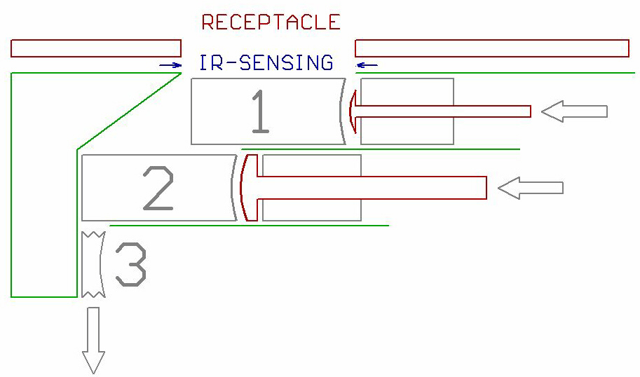

Concerning the mechanical construction of such a device I prefer pneumatically driven pistons. They operate silently (with silencers at the exhaust port) and have almost no wear and tear.
This is about how it could look like. There are two pistons for safety reasons. If somebody reaches in he has to reach in the way to break his arm before the piston can do the job.
