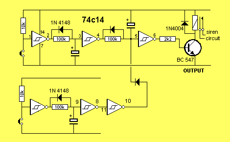

i have done some research and know that you can use a 555 timer for a time delay circuit with a switch to start it. what i am needing is a time delay that requires you to hold down the switch for say 30 seconds to start another timing circuit that goes for say 10 mins which then can be terminated by another delay circuit as the first. hope that's not confusing
would a micro controller be needed

and i need the push button held down for 30 seconds and if released the 30 seconds starts over so the button has to be held for 30 seconds and then i starts like a 5 min timer that sets off a buzzer siren after the five minutes or by holding a second push button for 30 seconds its terminated and resets the whole thing im thinkin a PiC is what i need but if it can be done with a 555 timer or a 556 timer that would be better
Here is the circuit you require:
what chip is this with 555,556, something else?
never mind chip is a 74c14 i need to pay closer attention to things
and i understand most of the symbols in your diagram but a few i have never seen any way you could make me a legend so i could understand the circuit a little better i would greatly appreciate it :)
would this be the same thing?
