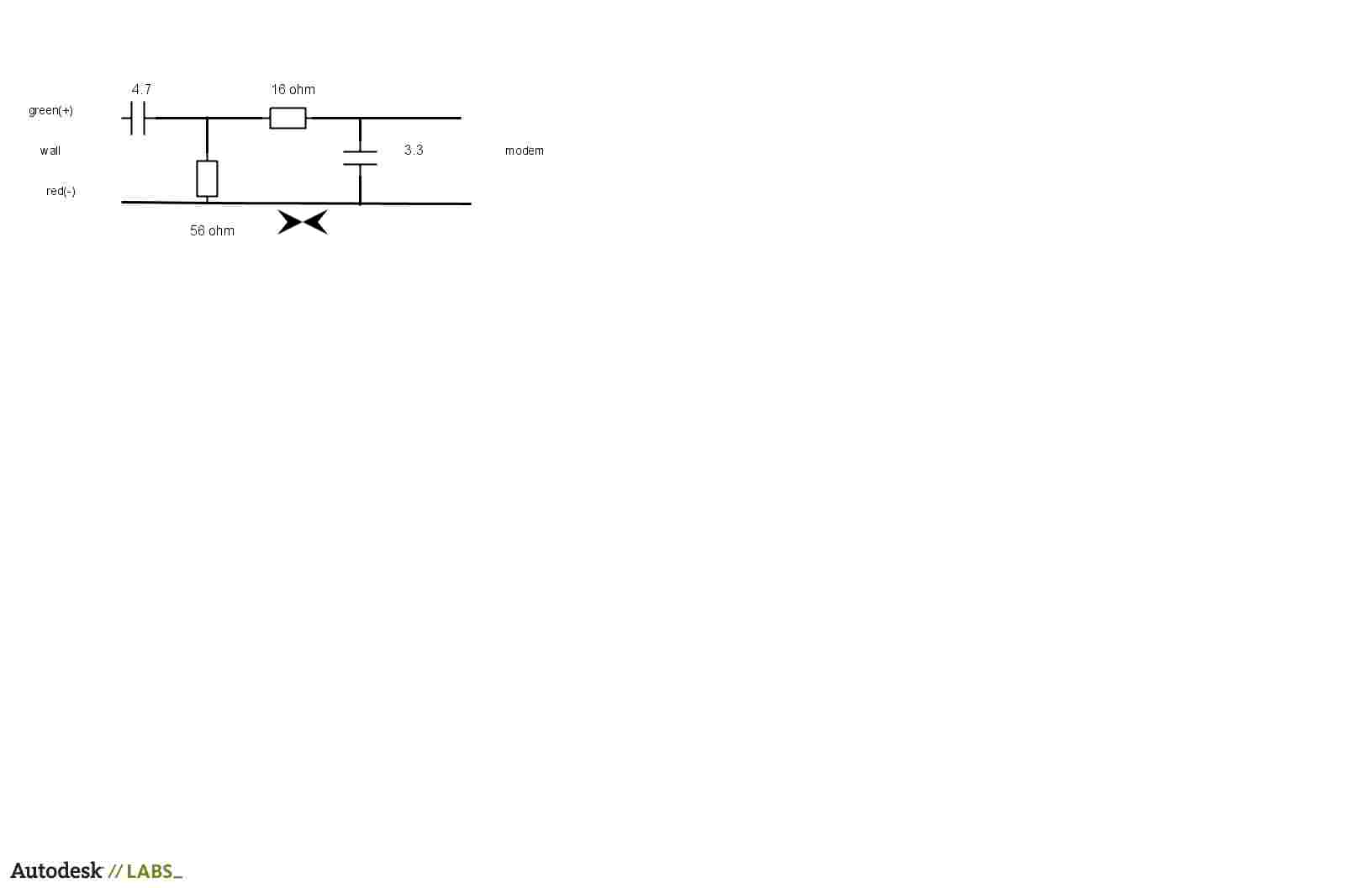

Let me ask for forgivness in advance if this is not the right place to post this. I know just enough about electronics to be dangerous.
I have a lot of noise on my phone line and I am trying to design a band pass filter to block noise so hopefully my modem will run faster. From what I have been able to find on the internet dialup uses the frequency between 600-3000hz.
The following attached schematic is a design that, I was hoping with my limited knowledge on the subject, would allow the frequency band of 605-3014 to pass through. When I inserted this into the phone circuit I could not get a dial tone. I then tried just a high pass filter with a 4.7 cap connected to the green(+) line followed by a 56 ohm resistor connected in series and then the resistor connected to the red(-) line. This did reduce noise level somewhat but instead of the internet connection being faster it was slower.
Next I tried a low pass filter with a 16 ohm resistor connected to the green(+) wire followed by a 3.3 cap connected in series and then the cap connected to the red(-) wire. The modem would not connect with this setup.
Would anyone have any thoughts, ideas or suggestons as to what I am doing wrong or could you offer some things that I might try.

I had the phone line checked by the phone company, and even though they admit there is a lot of noise on the line, they said, by law, it is good enough as long as someone can carry on a conversation.

Find out what law it is and make sure they're not mis interpreting it. If you complain enough they have to fix it.
As Bill suggested, you can't filter it, you would just make it even worse.
Certainly in the UK phone companies only guarantee a voice quality line, if that's excessively noisey then they will fix it, but they aren't interested in complaints of poor modem speed, and have no obligation to sort it out.

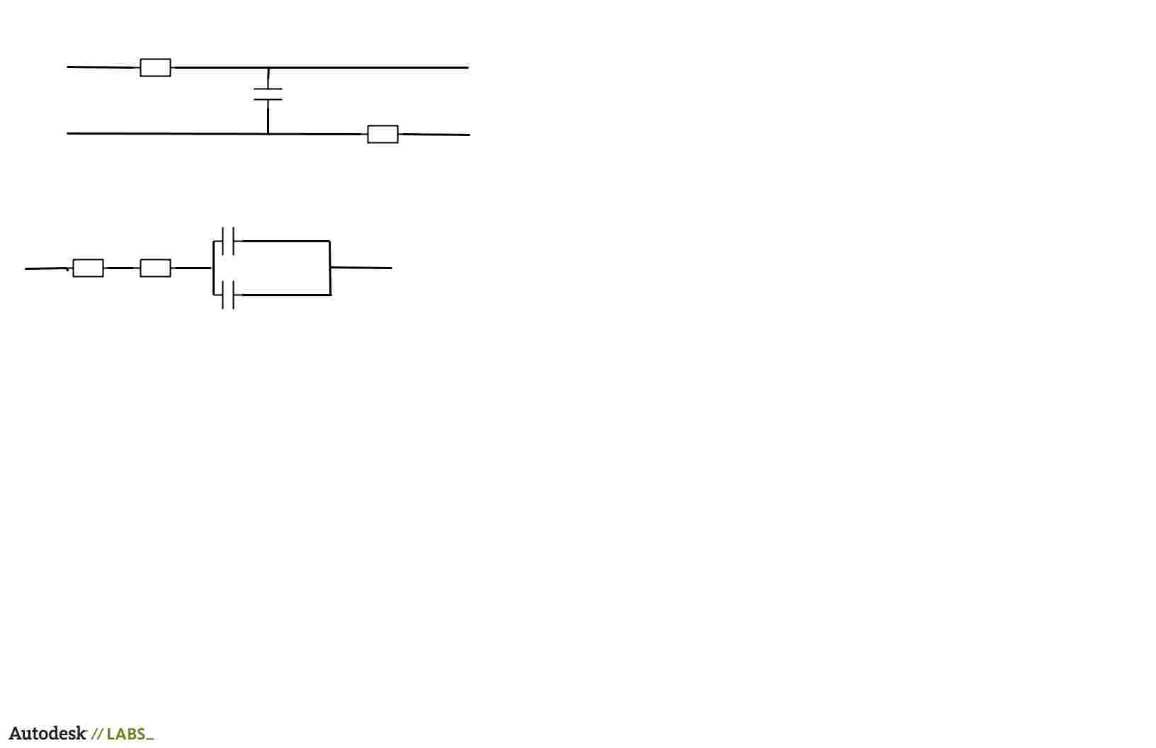

Could you guys take a look at the following links and attachment and tell me what you think? It looks like some people have been successful at making a filter that will help with dialup internet speed.
Telephone line noise filter apparatus - Patent 5073924
Some people have used the attached schematics with some success.

If you think those circuits will help, then try them - you've nothing to lose.
You might even try plugging an ADSL filter in (using the phone output), see if that helps at all.
How many phones do you have connected in parrallel with your internet connection ?
Anything connected in parrallel while using the internet will reduce you landline speed.

Try this and see if the noise disappears.
Disconnect all your phones from their sockets and have the computer only using the phone line by itself.
Ensure that the computer modem has a "clean" line.
Do your data transfer and see if the speed improves.
If the noise disappears the problem is with one of your phones.
If noise or low speed still persists, you may have a dodgy, corroded connection and the problem is most likely there or it is on the Telco side.
