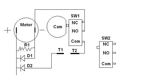

I need a little help on this. I think I found a motor assembly that will work for an application I am trying to do. This assembly is surplus and it looks like it’s out of a vending machine. I thought this thing would do what I wanted it to as is but it doesn’t seem to.
The cam is geared to the motor. The circuit shown is on a little circuit board setting next to the cam. T1 and T2 are just terminals sticking out of the board. It is a 6 to 24 volt motor. SW1 and SW2 are micro switches.
What I want to do is to be able to push SW2 and have the cam make one whole revolution and then stop until SW2 is pressed again. It would be nice to be able to just modify the circuit that is there but if you have a better way to do it let me know. Thanks

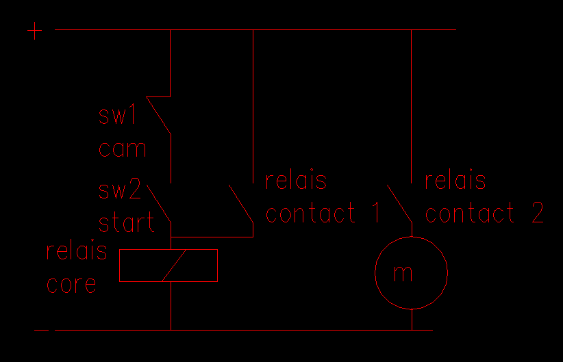

I think that's easy to do with a self holding relais. Pushing the switch SW2 closes the relais and 2 contacts of the relais are used to maintain the relais). The NC part of SW1 is then used to cut the power to the relais and the motor stops. A couple of buts are attached to this approach.
If you push SW2 too long the motor will keep running past the cam. And you need to push SW2 long enough to allow SW1 to close again.
I've added a sketch to clarify myself.

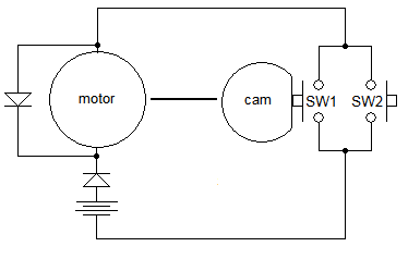

Try this. You have to press SW2 long enough for SW1 to close, and release it before a full rotation is finished.

Thanks for the help. I am using Ron’s circuit and it works fine. I’m nor sure exactly what that little circuit does that is on the board but this works fine without it so I will probably take the parts off. Are the diodes necessary? Right now I am running it without them. Stevez is right, I do need something to keep the motor running for 2 to 3 seconds until the cam pushes the micro switch in for the rest of the revolution. I might be able to build the flat on the cam up a little bit but I would still need to do it for about a second. Any suggestions?
The "start" switch could be replaced with an SCR, the second switch would turn off the SCR by shorting it out. This would allow for very short duration presses of the starting switch. WE have similar ciruits on some electric actuators at work, the only difference is that the motor reverses at the end of a cycle.

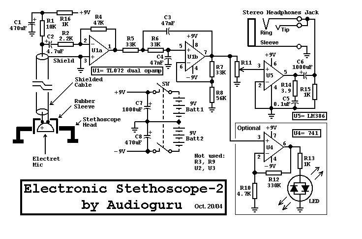

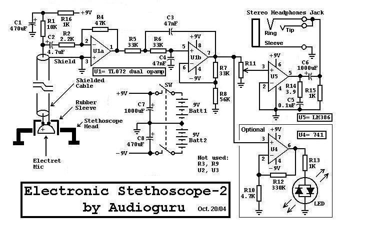

Here's the 1st schematic I ever made on a pc. The original was a slightly fuzzy JPG so I continued modifying it as a JPG and it got fuzzier and fuzzier. If it started as a GIF or PNG then continued, it would look perfect.
