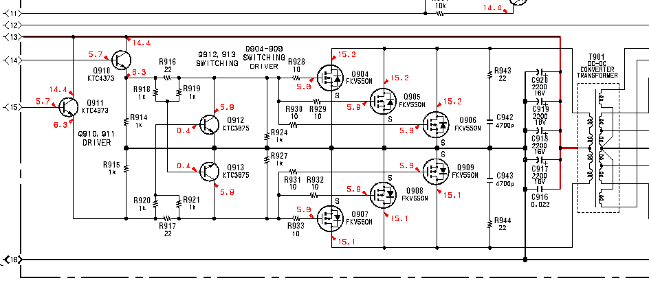

Here are some parts of the circuit for a Sony in-car amp, it's rated at 200W RMS per channel into 4 ohms, 250W per channel into 2 ohms, or 500W bridged into 4 ohms.
The Sony amp has only 34 transistors!
A lot of its max ouput power is wasted heating-up the output Mosfets due to their high G-S turn-on voltage!
It would be much more efficient with ordinary power transistors. The power that is wasted could be used to heat the speakers and your ears more. :lol: :lol:
