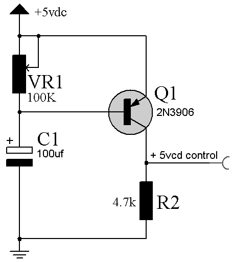

"I want to have 1 circuit beep once for 1 second when I power on my power supply, then never beep until the supply is turned on again."
Maybe this will do. Comments please.
Edit: Oops! Add a 1M resistor across the cap.

Whats the 1M0 resistor across the cap do.???
See, that's what I mean, and then indeed you should add a extra resistor across the cap so it discharges when the power is turned off...
But dosnt the cap discharge back thru the 100K pot when the +5v dies away.???:rolleyes:

Your circuit should give a 'beep' when powered up.
Initially the cap is discharged, when the +5V is applied the cap charges via the 100K towards +5V.
While the cap is charging the base of the transistor is forward biassed, so the transistor is on.
When the voltage on the cap rises to within 0.6V of 5V [+4.4V] the transistor will switch off.
When the +5V supply is switched off, the cap will discharge thru the 100K pot as the +5V slowly decays
[ back thru the rest of the circuits supplied by the +5v]
I did not know what the rest of the circuits will be or where the switch will be so I thought it might be a good idea to add a discharge resistor.
To avoid math and the facts that I would get it wrong anyway + the wide cap tolerance and other variables (what will Vcc be?), the pot will set the timing.
The problem with adding a 1M0, this together with the leakage resistance of the 100uF could hold the transistor ON.
Yes the pot will set the charge time for the cap.
If you mean the Vcc on the transistor collector wrt 0V, when the transistor is conducting it could be about 4.8V.

"If you mean the Vcc on the transistor collector wrt 0V, when the transistor is conducting it could be about 4.8V."
wrt?
No, I mean I don't exactly know the base voltages that will turn on (enough) and off the transistor to set the timing without building and testing the circuit. Hence the pot.
wrt?
The 'wrt' is shorthand way of writing 'with respect to', all that means in this case, is the -V lead of a volt meter connected to 0V/Common as the reference level. [ with the +V lead to the collector]
The turn on voltage for most silicon transistors is 0.6V~0.65V
So while the cap voltage is less than [+5V - 0.6V] the transistor will be on.
