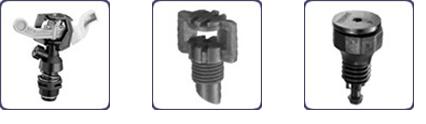

just to cool the roof of your house you don't need "rivers" to flow down the roof. Keeping the roof wet is all you need.
Cooling is achieved by evaporation of water using the so called "chill effect".
The amount of water to be distributed over the roof is not great and you might get along with a fairly strong water pump of the kind used in camping mobiles.
From the roof size I suggest to mount five spray nozzles approximately 1m above the roof top and have the water being sprayed evenly.
Spray nozzles (usually used to spray insecticides) can be found in garden accessory shops. Most of them are adjustable for throughput and spray angle.
For the pipes I suggest copper hoses of 8mm diameter inside. (10-12mm outside). Fittings are easily to be soft soldered (using soldering tin) which is strong enough to withstand high pressure up to 10bar (~200psi)
For automatic operation you just need a thermistor and and a comparator circuit to be followed by a relay switching the pump on. If your solar panels deliver enough current you won't have to stabilize the output voltage. Just hook up the pump directly to the panels.

the simplest thing you can make is simple pipe work (pvc)
drill small holes in it 1 a 2 mm
put it on the roof and conect that on the city water system with a solenoid valve
the solenoid valve is operated by a temp sensor conected on the roof
you will have the build up of minerals and somtimes algea on the roof over time

which one work best?which type?
