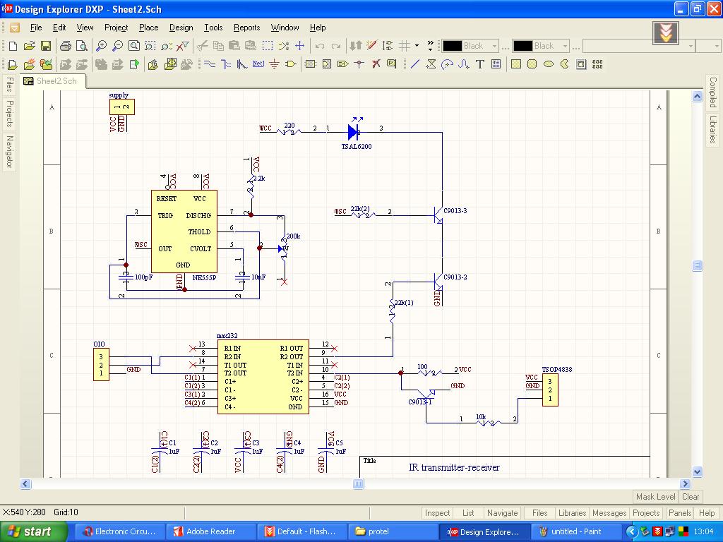

can anyone help to solve this problem?
I'm building a serial communication with IR transmitter-receiver, but the maximum speed is only 2400bps. I need to speed up the transfer rate... Any solution? this is the schematic..
thanks for the help..

Modulate the IR transmit and decode the IR reception yourself. If you're close enough you can basically make a close coupled opto-coupler, which is capable of some pretty high baud rates compareable even to a local interconnect.. As you move away and add noise from the surrounding environment maximum baud rate will degrade obviously but you have to determine for yourself in your application if IR is the right choice, and at what distance it will be useable.

i assume the 2400 limit you found is by experimentation , i think your first bottle neck is the modulated ir receiver the tsop .
i guess you're right. I've studied the TSOP datasheet. it say that the receiver should receive 10 burst minimum for every bit. When i used 2400 baud rate, TSOP receives 15 burst, but when i used 4800 it drops to 7 burst (by calculation)..
thanks for any help..
I have another "bugs".. It seems that the data sent by the IR led, reflected to the TSOP at the same side.... second bugs is that the distance is only about 10-15 cm... (i'm sorry, i don't use inch).. Does anyone here, can help me with the better circuit?
Install a barrier between your IR LED and the TSOP receiver for isolation.
Your range is too short. It should go 10m or farther. Something is connected backwards.
thanks! the barrier did solve the problem.. but I'm sorry, i'm a little bit confused.. What's the meaning of "something is connected backwards"?

If a transistor is connected backwards then its collector and emitter are reversed. Instead of a current gain of 200, its gain will be about 5. It will work very poorly. American and European little transistors have their pin positions opposite. Then it is easy to use a different transistor and connect it backwards.
I don't know what happens if a TSOP is connected backwards.
