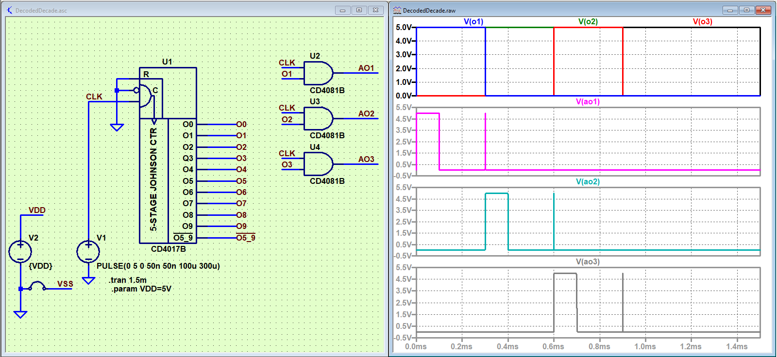

You diagram does NOT look like the output of a decade counter.
That is because the CD4017 is a 5-stage Johnson Counter with decoded outputs.
This is what you might get with AND gates. Too bad about the possible trailing edge glitches.
The easiest way is to have an AND gate for each output.
One input to each AND gate would be the clock input.
The other input to the AND gate would be one of A1, A2 or A3.
The output of the AND gate would have the waveform that you want.
Thank you very much Diver300, You mean like the diagram below
In theory, I think it would work well.
I think my problem is solved, Diver300, thanks again.

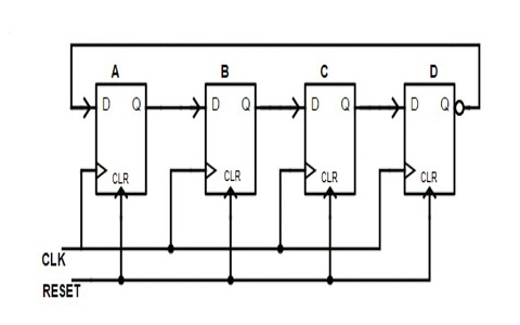

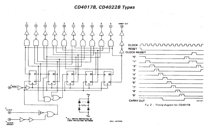

That is because the CD4017 it is a 5-stage Johnson Counter with decoded outputs.
Papabravo, I don't know the difference between 5 Stage Johnson Counter, my knowledge about electronics is very low
If refer to the video about 5 Stage Johnson Counter Using 4017BP
Output ic4017BP as diagram danadak gives
I think the guide provided by Diver300 can work well
Anyway, thank you Papabravo and danadak for the feedback given

Yes, that is what I meant.
If you also connect the Q3 output of the 4017 to the reset input of the 4017, you will get the waveform that you showed in your first post.
Q3
previously I thought Q4 needed to be connected to the reset to activate the 3 outputs Q0, Q1 and Q2
Thank you
It's Q3.
Starting at Q0 is on.
Next rising edge of clock causes Q1 to turn on
Next rising edge of clock causes Q2 to turn on
Next rising edge of clock causes Q3 to turn on. If that is connected to the reset, very soon after than, Q3 will turn off and Q0 will turn on, and it's back to the start.
Q3
Thank you
It's Q3.
