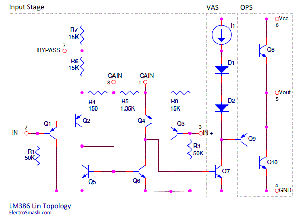

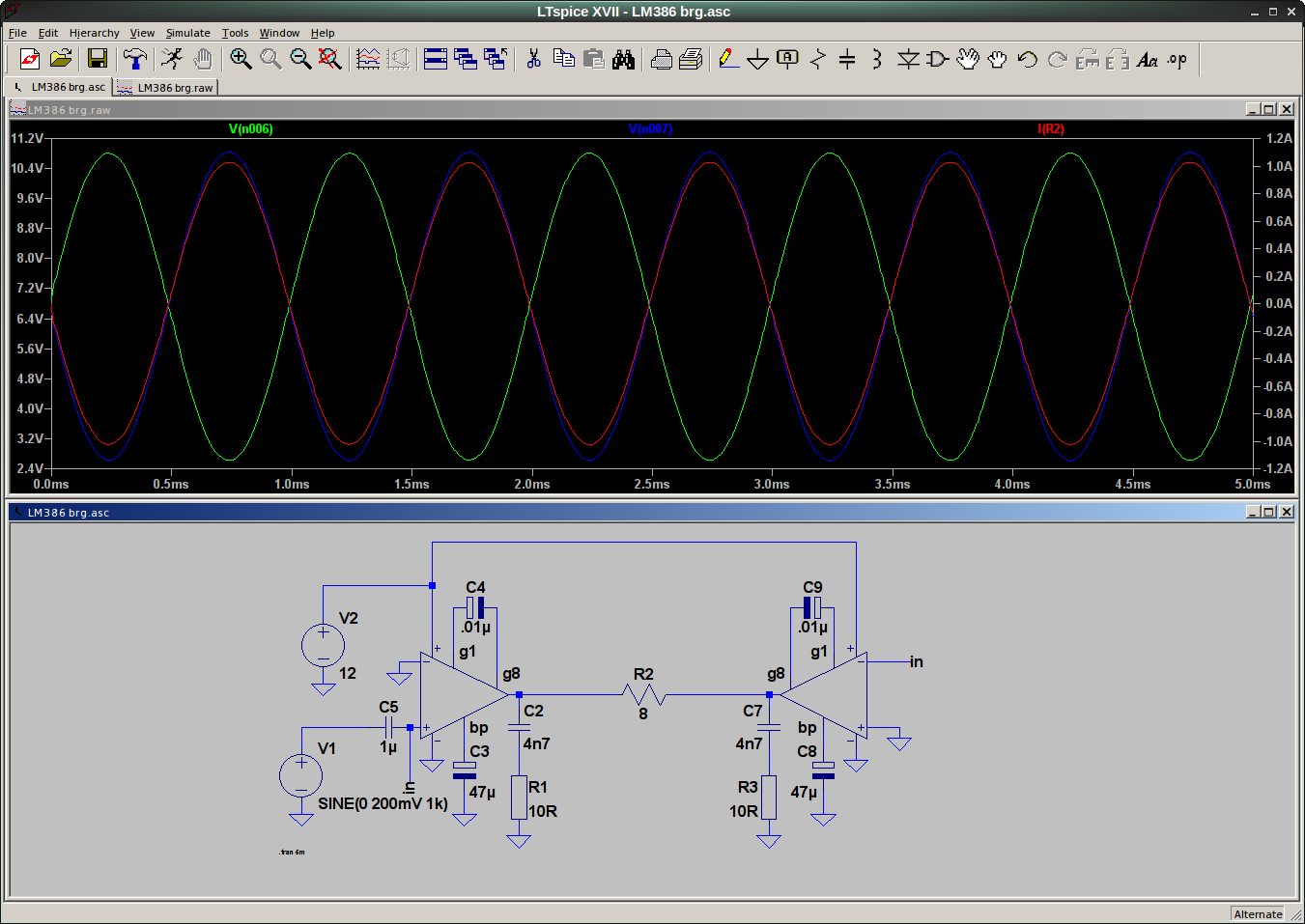

except for the internal feedback network (instead of external), it's an op amp, with a diff amp, current mirror, voltage amp, and class ab output stage. most analog power amps are basically an op amp. the LM386 has the inverting and noninverting inputs available as a normal op amp would. 50k input impedance is fine for most guitars, and that's the value used for the volume control pots in most guitars. i've used LM386 practice amps, and they work fine. it's actually very simple to use two LM386 chips for a bridged output because you do have both inputs available. like this:
don't use a 4 ohm speaker with the bridged circuit. a single 8 ohm speaker is pushing the envelope as well. two 8 ohm speakers in series would be preferable. each amplifier only "sees" half of the load impedance in a bridged amp. the other advantage to this configuration is that the large capacitors between the amp and speaker aren't needed.

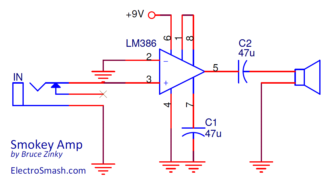

another advantage of using an LM386, is the fact that you can make a very minimalist amplifier:
two caps, a connector, speaker and battery... can't get much simpler than that

A review of the Smokey amp says that the low 50k load on the guitar pickup causes a dark muddy sound that might be balanced by the tiny output capacitor cutting low frequencies. The review says a high input impedance buffer would be a good idea. This review and other reviews say the Smokey amp is missing important parts shown on the datasheet of the LM386 therefore it is always distorted and cannot produce a clean sound.

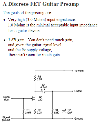

Here is a guitar preamp that uses a Jfet and has a 3M input impedance and says that 1M is the minimal acceptable input impedance for a guitar device.

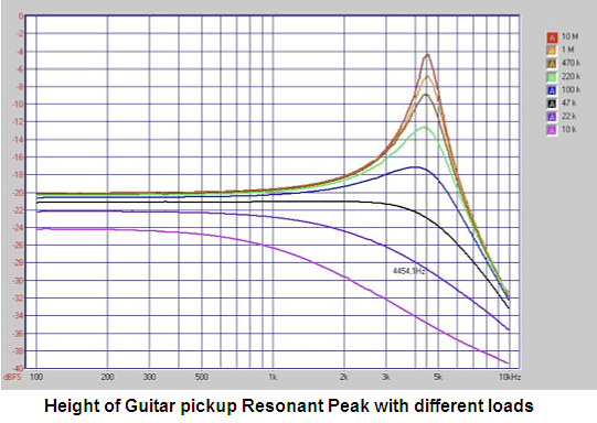

Here is a graph showing the guitar pickup resonates with cable capacitance and produces a peak in the upper midrange frequencies when its load impedance is high. When the load is only 50k ohms then the response is missing high frequencies like the hearing of an old person who needs a hearing aid.
