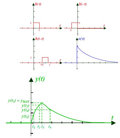

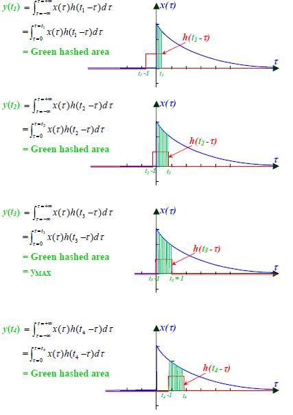

But if you need the graphical method, you should just draw the graph for each function, and then choose one to be the (tau) function, and the other the (t - tau) function. Then choose accordingly the ranges of tau, and your function would be the product of the intersection of the functions.
Here's some helpful (I hope) pics...
