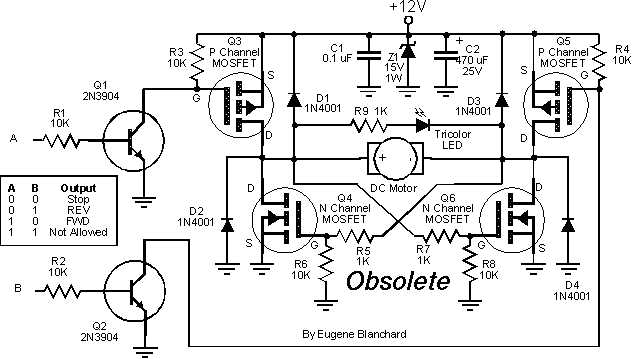

my project is to build a mobile robot consists of 4 brushed dc motor whereas 2 for the left side that will be running together and 2 for the right side. my problem is with the motor driver.
i wish to build a h bridge that can drive 2 dc brushed motor (usually used as a car power window motor) and connected the h bridge to a servo motor circuit (after removing the small dc motor inside). the gearing system from the power window motor being removed, so the shaft of the motor will be directed to a tyre.
ive built some h bridge but most of them using both p and n channel mosfet. the problem is, i cant find a high ampere p channel at my place. but its not a problem for a n channel mosfet.
attach is the one of it that ive built. but it cannot last for long. after 20 minutes running the mosfet will burnt out. do not know how. i used a very big heat sink.
thanx for helping me.......

how much current do you need?
have you tried the l293D load driver ic? it can drive, in ceratin conditions, up to 4A... (if you connect the 4 channels in parallel....)
i wouldn't consider 4A high current. dc motors used in car seats and doors draw easily 5-6 Amp with no load,
8-12 Amp with light load and stall current can be much higher (25Amp or more).

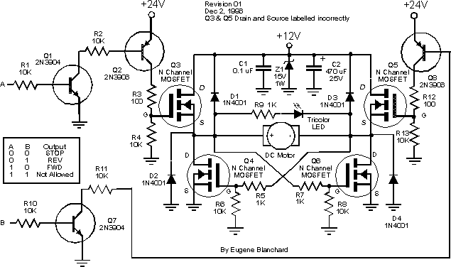

ive done building this circuit using 1rfz44. firstly it work perfectly. but the second time i tried it, it cannot work..... why? the mosfet is very hot...
thanx..

What freq are you running it at?

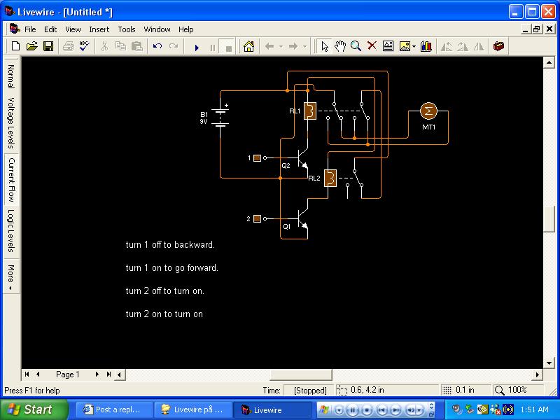

do you need a h bridge do somthing more simple.
sorry turn 2 on to turn off.

interesting circuit... i wonder what was the guidline in sizing
of the circuit - 50Amp transistors and 1A diodes, 24V source to turn on mosfets...
according to datasheet, absolute maximum for Vgs is only 20V.
the same document also shows that Vgs of only 3V is going to turn the
transistor fully on. Fortunatelly these transistors have built in diodes so
presence of puny 1N4001 is purely cosmetic.

Since you are using the servo driver circuit it may be frying FETs because the driver may actually be keeping the line that is supposed to go LOW above ground, keeping the FETs that are supposed to turn off, on just a bit and creating a short circuit through the FETS.
Try the IRFB4410's 10v sat and 96A. I have use them on 200 amp loads for surprisingly long periods and they have held up fine.
Also, try NOT using a heatsink and using a fan only on the fets, they cool much better this way as long as its cool air being blown on them.
