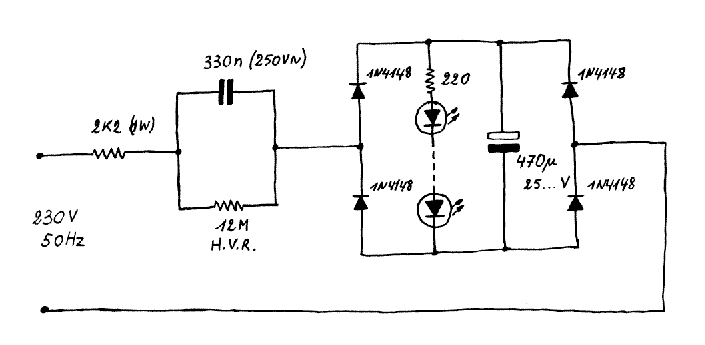

Hi Ahkyo,
You wanted a lousy circuit he, here's one. Enjoy ! :D
I used eight ordinary red led's. If you want to use it on a different
line voltage or at a different line frequency you gonna have to scale
the 330 nF capacitor up or down. The voltage drop over the 220 :eek:hm:
resistor should be about 5 volt. Also note that you might have to
increase the working voltage of the 470 µF capacitor if the voltage
drop over the leds increases.
on1aag.

sigh. first a repeat safety lecture. high voltage can kill you. don't mess around with it until you know 100% what you are doing. Use a wall transformer (aka wall wart) to get to a much much safer voltage.
I will assume that you mean a better circuit. OK, go look up an LM7805 datasheet - there is a circuit that shows how to use it to get 5V. Use a 9V wall wart to power this circuit. (you can find them in thrift stores cheap). assuming your LED has a Vf of 3.5V and a sugggested If of 20 mA, use a 75 ohm resistor. (look up the datasheet) Attach one end of the resistor to +5 and the other end to the LED's anode. attach the cathode to ground. apply power, bask in the blue light.
