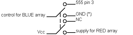

lets also include a pic, i want the red off when the manual switch is thrown to turn the blues on(555 yes they are blinking), and then when the manual switch is turned off the blues go off and the reds come back on
Would this work? I'm assuming pin 3 of the 555 is an active high control for the blue array. NC means not connected.

okay so the only thing i am missing in this pic is the manual swich on the blue array.
so imagine this is a motorcycle or car brake/running light (red) it is always on, then you flip a switch that is connected to the blue array that turns the flashing on, so that the blue isnt washed out by the red, i need something that turns the red off. i am so sorry that i cant ask this question correctly :)
oh and pc88 im not sure if thats what you posted but i guess i can try it ...just need to be able to understand it, could you explain it i n idiot form for me, i just got into creating the 555 so iam stupid in EE stuff

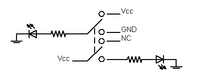

Hook up a DPDT switch like in the diagram below, and you'll see how it works. You're controlling two circuits with one switch. In the "up" position, only the LED on the left will light up. In the "down" position only the the LED on the right will light up.

okay, yes that would work, BUT is there a curcuit out there that can do the same thing. i want this to be electronically controlled. is it possible? i like the "if then" idea of it.
Do you mean you want the DPDT switch to be controlled by another electronic circuit? There are DPDT relays you can use.
But it sounds like your application is going to have a switch that is activated by the user, so why not just have them activate the DPDT switch directly?

okay so the red is hard wired in to the bikes system, i do not want to cut the wire, rather just connect the 555 and relay or what ever to it , i understand that that switch would be the easiest method, but all i want is one wire coming from the 555 to a single throw switch, then i can connect the other end to a power source.
this whole system, red, blue, 555, and relay(what ever it is i use) will all be in a very compact area. not that this matters, but just so you know. i can beilive that the only solution in the world of electronics is this switch.....i thought that there would be a simple little gate or something, or relay, that could do this with out a problem
I don't think you can accomplish what you want to do without splicing something into your brake light circuit, and this will mean either cutting a wire or desoldering something.
Now, if you only want two wires going to your activation switch, just have the switch activate a DPDT relay. Relays can be very small, and they're used all the time in automotive applications.
Yes, a DPDT relay will work like that. Just hook it up like I diagrammed in my second posting of Aug. 14th. The relay will have two other connections for the coil. When current flows through the coil, the switch contacts will move from their "up" position to their "down" position. A spring will restore the switch contacts to the "up" position if current stops flowing through the coil.
