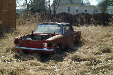

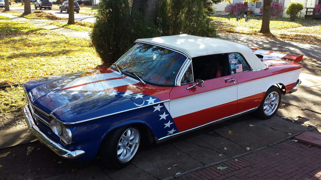

I will try to post 2 pics of the car, they were taken 2 years apart. 1 as I got the car, the other after I finished it. First car I painted since 1974!

Like the before and after pics of the Corvair- some hard work has been expended there.:cool:
The last car I completely resprayed was in 1989.

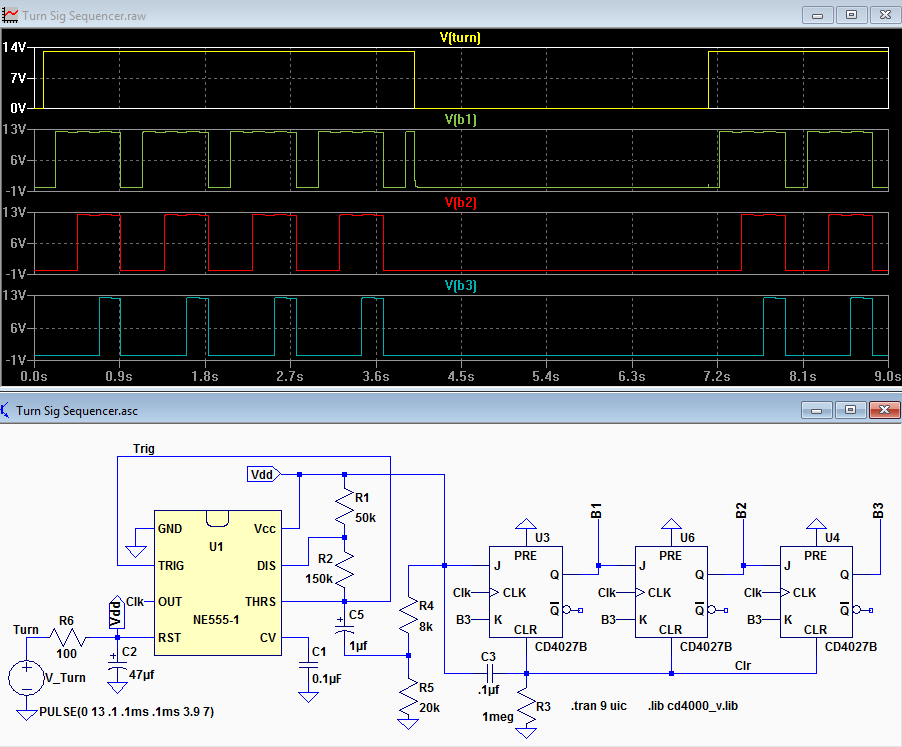

Here's the LTspice simulation of a 555 circuit that I think does what you want.
The circuit uses one 555 timer, and two CD4027 JK flip-flop chips, plus resistors and capacitors.
Outputs B1, B2, and B3 control the bulbs (B1 is inside).
It continues the sequence as long as the Turn signal voltage is high (simulated by V_Turn source on left).
The values of R2 and C5 determine the speed of the sequence.
The values shown give a complete sequence time of about 0.9 seconds.
Higher values slow it down.
You will need to add a transistor driver to each output for whatever the bulb current is.
(If you know the bulb current, we can help with that. Are they incandescent or LED?)
Power and ground for the CD4027 chips are not shown but must be connected.
Be sure and tie all unused inputs on the spare 4027 to ground to avoid any erratic behavior.

Thank you for the kind words! I added 4 wheel disc brakes, made the caliper mounts in my shop, and modified calipers and rotors. Next I want to add rack and pinion steering. Always something!

OK, I ordered parts from DigiKey, and should have them soon. I do have some questions regarding reading your schematic. I gather the triangular arrows are indicating ground. Now on the CD4027B chips, the arrow at the top is that ground, or showing which end of the chip is pin 1? I assume the CLR at the bottom is connected to ground through R3, and also to C3 then to other points shown. I see also that C2 and C5 are the only caps that have polarity. Is it that they are the only ones with polarity, or the only ones where polarity matters? (basically asking if all caps have polarity or not). Then also on the lower left is a circle with + top and - bottom is that just to illustrate what ever I am using to switch on the power? And lastly (for now! LOL!) I assume the CLK on the flip flops are all connected.
Sorry for all the basic questions, I appreciate your help greatly!
