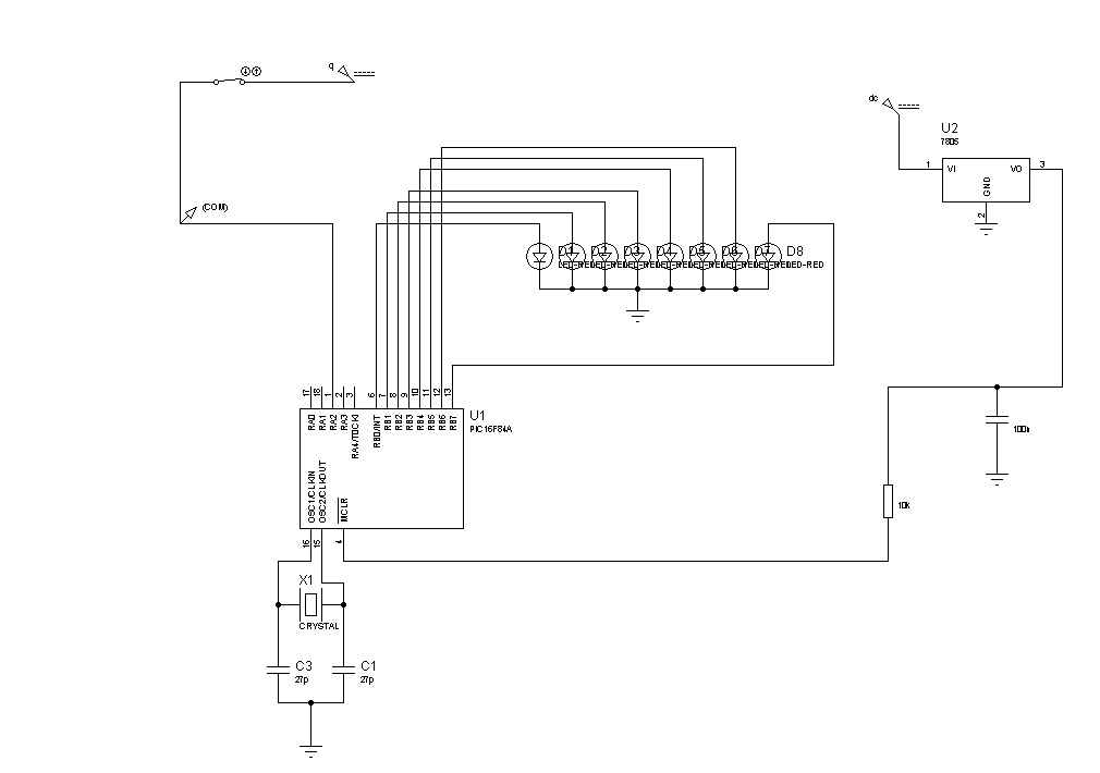

i need little help in proteus designing ....
my project is : propeller display using pic16f84a
and this is the schematic and hex file View attachment propeller.zip
my problem is how to add the motor and make the leds rotate so then i can clearly see how my program work .....
any body help me in this ??
you need to construct the pcb on the propeller itself and even put the battery on it. the motor, leave it work on an other supply. If you need to check the rpm of the motor, just attach a hall effect sensor on the propeller too and read the spinning. check this projects might help: **broken link removed**
