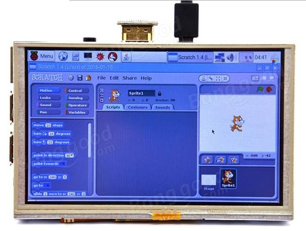

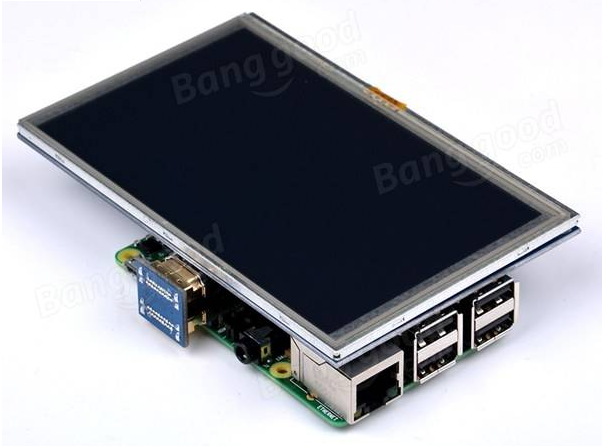

Here is a 5" touch screen for a Raspberry Pi.
The LCD is $29 and the Raspberry Pi 3 is $35.
https://www.banggood.com/5-Inch-800...berry-PI-3-Model-B2-Model-BBAB-p-1054289.html
I can't find a 7" but I have seen them.
The Raspberry Pi 3 does not have 100 I/O pins. BUT You can get from many places expansion boards that add 8 or 16 or 32 more.
