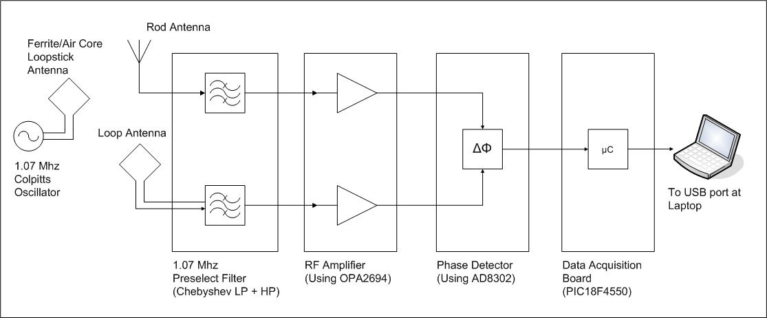

I think this frequency should be suitable since there is no AM radio channel in my country... Here is my block diagram of my system... Any comments on this system?

Your diagram is very good. We have several steps to do now. We must record the gain or loss of signal (preferably in dB) that we expect through each block. We must also determine whether each block is capable of handling the frequency. (judging by the chosen parts, it seems you've already done this, but I would like to know exactly what gain you expect in each stage).
I have some observations about your choices so far. First of all, I wonder if you are choosing the easiest kind of filter topology for input. You indicate the filter to be a Chebyshev LP + HP, which will become fairly complicated with many components. A simpler and more selective filter can be realized using multiple resonant tank circuits which are coupled together. In this configuration, a single resonant tank is simply one capacitor and one inductor connected in parallel with one side to ground and the other side being called the "hot" side. One of these tank circuits can have high Q, so if you couple several of these tank circuits together, you can get extremely good selectivity which is desireable in this project I think. The methods for coupling energy into the first tank, and then coupling from one tank to the next are simple, but you will have to look them up in a book. The ARRL Handbook covers this pretty well, but it is a common practice in radio design so most radio circuit books would teach this.
Next, I see that the op amp you have chosen has plenty of performance and will provide you with at least 20 dB of gain, and has the potential for quite a bit more, although exactly how much isn't clear. Perhaps 70 dB. I think that this amplifier is overkill for your application. It offers much more bandwidth than you need or want which may get you into trouble. The problem with too much bandwidth capability in an amplifier is simply that you invite instability at frequencies well away from the frequency you are operating on. Circuit board layout, decoupling and shielding may become quite critical, especially if you try to get a lot of gain out of one opamp. For example, you may lay out your circuit board with practices that are suitable for 1 MHz, but the amplifier can amplify up to 100MHz and more, so you would have to use pcb layout practices that are suitable for 100MHz to avoid having the amplifier become an oscillator due to unintentional feedback.
If you are interested, we may research some simpler choices, but you would have to do the work, I can only guide.
The phase detector AD8302 looks like a very good choice. It includes considerable additional gain, resulting in an input sensitivity of about -60 dBm which is very good. So, although it has very high performance bandwidth, much more than you need, it looks fairly easy to use so I approve.
The output of the phase detector will require a low pass filter, whose cutoff frequency you will have to choose. You should show this in your diagram. I presume that you will use an A/D converter in the PIC 18F4550, and this converter will have a limited bandwidth, so your low pass filter frequency should be chosen to avoid aliasing. Since you expect a fairly slow rate of change of phase, I think this filter cutoff can be quite a low frequency to be safe.
Judging the sensitivity of the system will require a knowledge of the gain of each stage, and then we will have to estimate or find out the expected noise figure of each stage. But worrying about the sensitivity is probably not very important just yet. Getting the thing basically operational is most important first.
What you are building here is essentially two Tuned Radio Frequency receivers (an old term). This simply means that each receiver amplifies the incoming signal to a level that is useful for demodulation (or in our case, for phase detection) without any frequency translation. This sort of receiver is not commonly used in simple analog broadcast receivers because it can be difficult to maintain stability of the amplifiers when they are working at 1 MHz and with gain as high as 80 dB or so (plus it is very tough to get good selectivity when you are tuning the amp from 550 KHz to 1700 MHz but we don't face that problem here). But this configuration is the best choice for your system. For additional selectivity and performance, you should strongly consider adding another bandpass filter between the RF amplifier and the Phase detector IC. I also want to add that you must assume that a PCB layout is needed as there is no way this circuit will work on plugboard, perfboard, or with point to point wiring. You must use a pcb properly layed out for high frequencies.

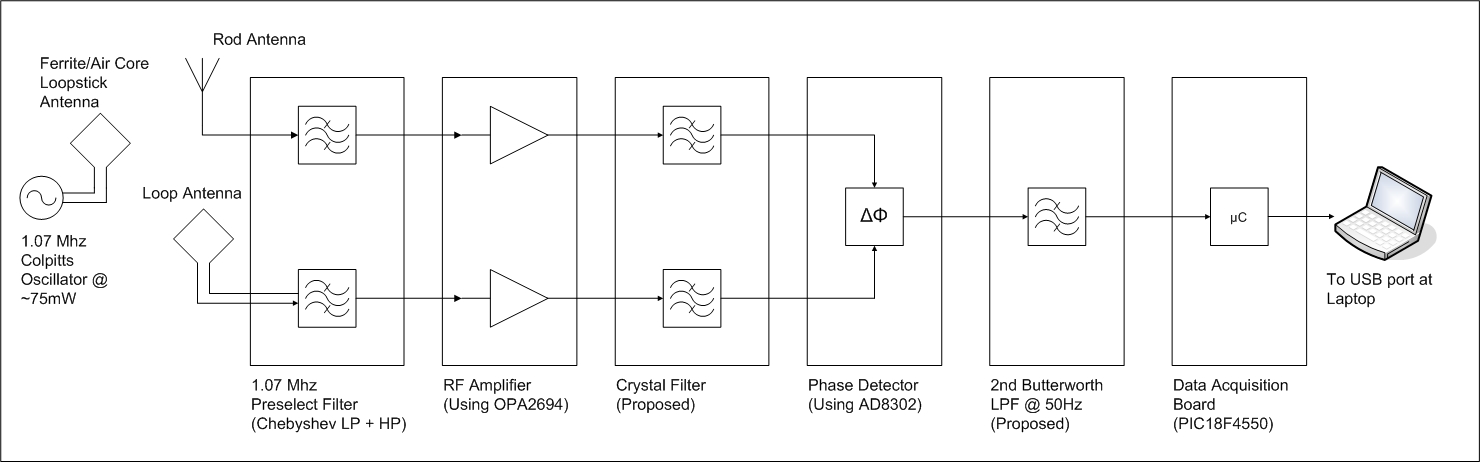

I have enclosed a new diagram of the system, as well as the schematic of the Colpitts Oscillator used in the transmitter... Any comments on the oscillator?

So many difficult questions! I'm not sure if the transmit power is high enough without doing some analysis. What is the legal maximum for such radiation in your country? Do you care about complying with rules, since this is only for demonstration? You diagram shows 75 mW which is a good level, perhaps enough to do the job. Again, some analyis is needed and I will show you how.
The rod antenna is very easy to simulate and I can do that quickly and tell you the gain. But the loop antenna is difficult and I cannot use my simulator for that one. We will have to find out the antenna gain by finding similar antennas that others have built and who have measured their gain figure and reported this in a report or website. This will take some time. Another way is to measure the gain of the antenna. This is possible if we are not too fussy about our accuracy. Can you provide any details about the tx antenna including a picture?

Regarding the bandpass filter between the amplifier and the phase detector, is it alright to implement a crystal filter there? I have no idea of any filter with better cutoff/ rolloff…
You could use a crystal filter and in fact the input impedance of the phase detector is suited to that. But you will have to find a crystal at the 1.05 MHz frequency. Since it is ok for the bandwidth to be quite narrow, you can get away with a crystal oscillator resonator instead of a filter. But we might have to cascade two of these and warp them a bit to get a few hz of bandwidth. If I were you, I would not use crystal to start with as it is an extra complication. I would build a cascaded tank circuit filter, same as recommended for the input filter.

Yes I have many clues. If I were designing this, I would not use an op amp. Instead, I would use an RF amplifier IC (not sure which one, this would require some research), or I would build a discrete tuned amplifier using a FET. At 1.05 MHz it is not hard to get a FET amplifier to work well for small signals.

Yes, it looks very strange. This circuit is not appropriate. You must use a crystal in the resonant circuit to stabilize the signal. Also, I would never use an opamp as a 1 MHz oscillator when it is so much simpler with a FET or bipolar transistor as an oscillator followed by a simple tuned buffer amplifier again made out of a FET or bipolar transistor. It seems that you are afraid of, or not knowedgeable of, design of amplifiers with discrete transistors. Such amplifiers are much more commonly used than opamps at frequencies like 1 MHz, especially in a narrowband application like this one where the tuned amplifier works well. But this is up to you. In any case, you must use a crystal.
Do you know how to make a simple crystal oscillator for use as a logic clock? This is usually done with a simple CMOS logic inverter. This would be the ideal oscillator and transmitter for you. Use a HEX Buffer IC (eg 74HCU04) and configure one buffer as a crystal oscillator, then feed the other buffers all in parallel and combine their outputs and then pass the signal through a 1 MHz chebyshev lowpass filter to remove harmonics. This is far simpler and is easy to do. I have seen links in another thread and will look for the example.
