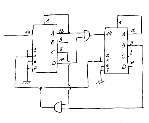

Hello to all. I'm new here, and I'm kinda noob on electronics stuff.
Recently, our Digital Circuits instructor is throwing yet another project on us to complete this week, and it's about making a digital clock made out of only pulse generator (analog circuit using LM555), decade counters (74LS90), BCD decoders (74LS47), AND Gate ICs (74LS08), and 7-segment LEDs. Our instructor intentionally gave us only the second-hand section of the diagram so that we have to use or brains to figure out the rest of the circuit (the minute-hand and the hour-hand). Yeah, it was a challenge to me coz I really got interested in these kind of projects, but I'm about to give it up already coz I'm all out of ideas. So far, I got only the "ones" part of the minute-hand section, and I had a really hard time to figure out the "tens" part. If you're getting confused about what I just said, let me elaborate you about this using an illustration:
This is what should look like in a clock, right?
But this is what I got so far.
As for the circuit diagram, you can take a look at it here:
https://i13.photobucket.com/albums/a251/dj_ash1983/circuit.jpg
I really need help from you guys so I can pass it on time. Thanks in advance, I really appreciate it.

Hi dj ash1983,
The circuit looks OK for the first two 74LS90's, forget the third one.
If you copy this part of the circuit twice you've got two divide by 60
counters. The clock of the third 74LS90 should be connected to the
output of the nand gate of the second 74LS90. Done that you've got
seconds "ones" and "tens" and minutes "ones" and "tens". The last part
is a divide by 24 counter. The clock of the fifth 74LS90 should be
connected to the output of the nand gate of the fourth 74LS90.

I got the hour-hand section (it went pretty smooth coz i just have to tinker the output wires to get the 12-hour format), but I think I had a hard time with the minute-hand part.
You said that "If you copy this part of the circuit twice", what part you are referring about? Oh yeah, I did copied the whole second-hand part of the cicuit but what I get was that the "ones" part is the only functional and not the "tens" part which is always "0".
Also, about what your said "The clock of the third 74LS90 should be connected to theoutput of the nand gate of the second 74LS90", there are 4 outputs (QA, QB, QC, and QD), right? Which of them should I connect?
Sorry to bother you, but can you make the whole second-hand and minute-hand circuit? Don't worry about the hour-hand, I got it already. :D
Thanks so much for your help. I really appreciate it. :D

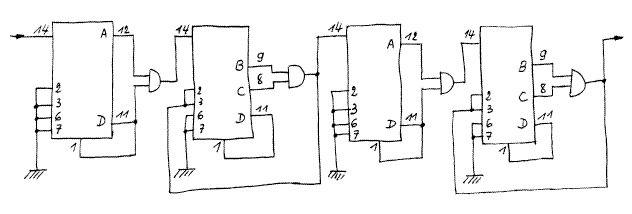

Hi dj ash1983,
Here's the rest of the circuit, it isn't that difficult.

I will post a schema from a TTL clock in the next couple of days.
I have built 6 of these with no major problems over the last 15 years for family.
Very important is to decouple each IC with a 100nF ceramic capacitor.

As for the schematic diagram, you may refer to the on1aag's attached pic (the 2nd pic). There's no more detailed that that anyway. And as for the "full" schematic diagram of the clock itself, the only part missing on on1aag's diagram is the clock pulse trigger diagram using LM555. Refer to my very diagram on my very first post.
If you guys REEEEEEEEEEEEALLY need a nice and neat schematic diagram, I can make one and post it here, but you guys have to wait since I have to find the circuitmaker pro from my backup cds first so I can verify it if it's working or not.
