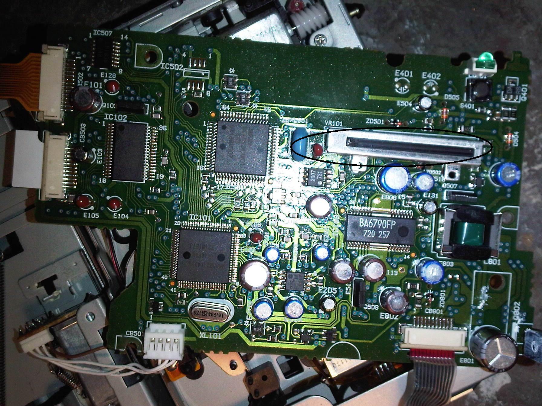

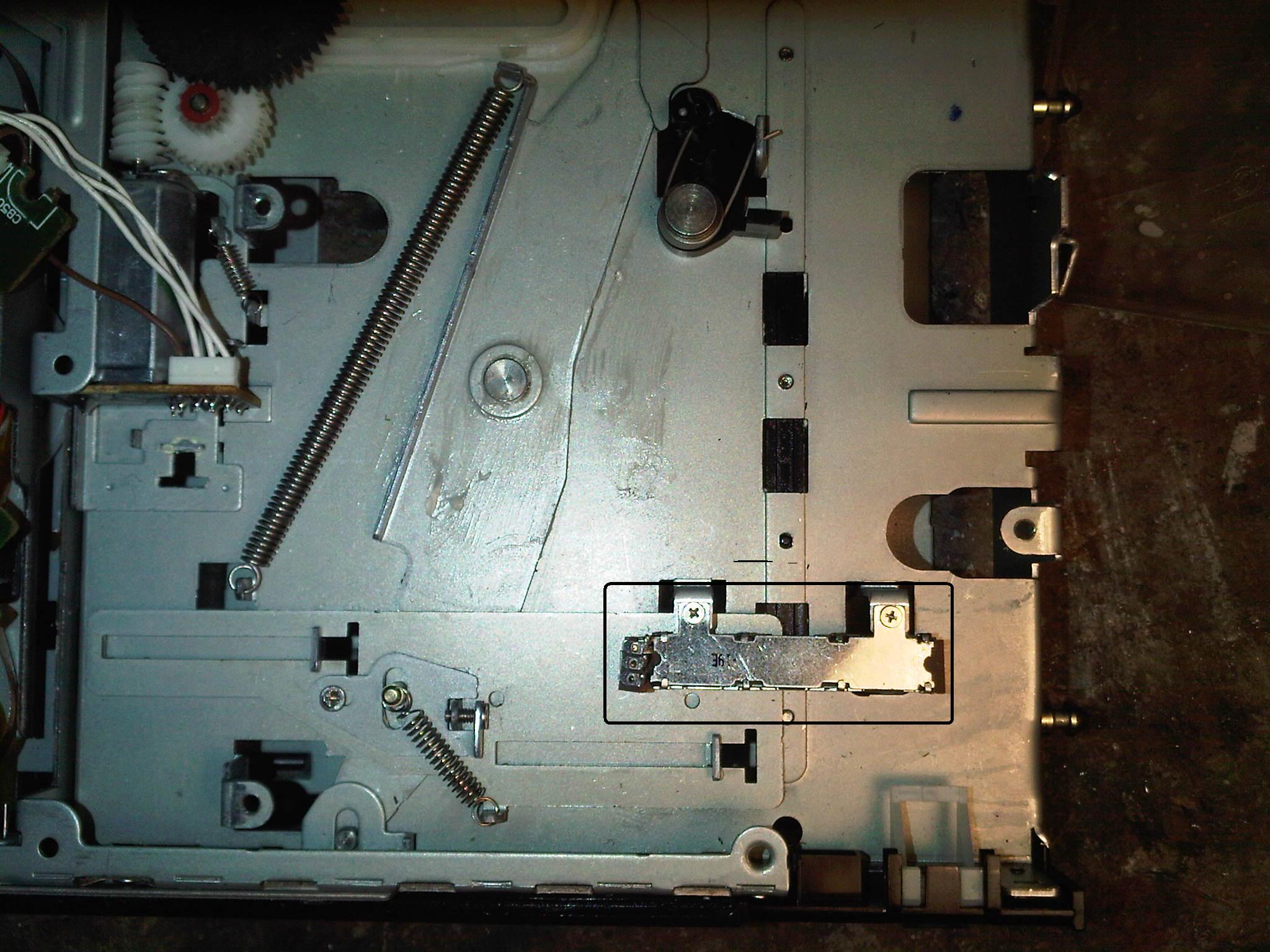

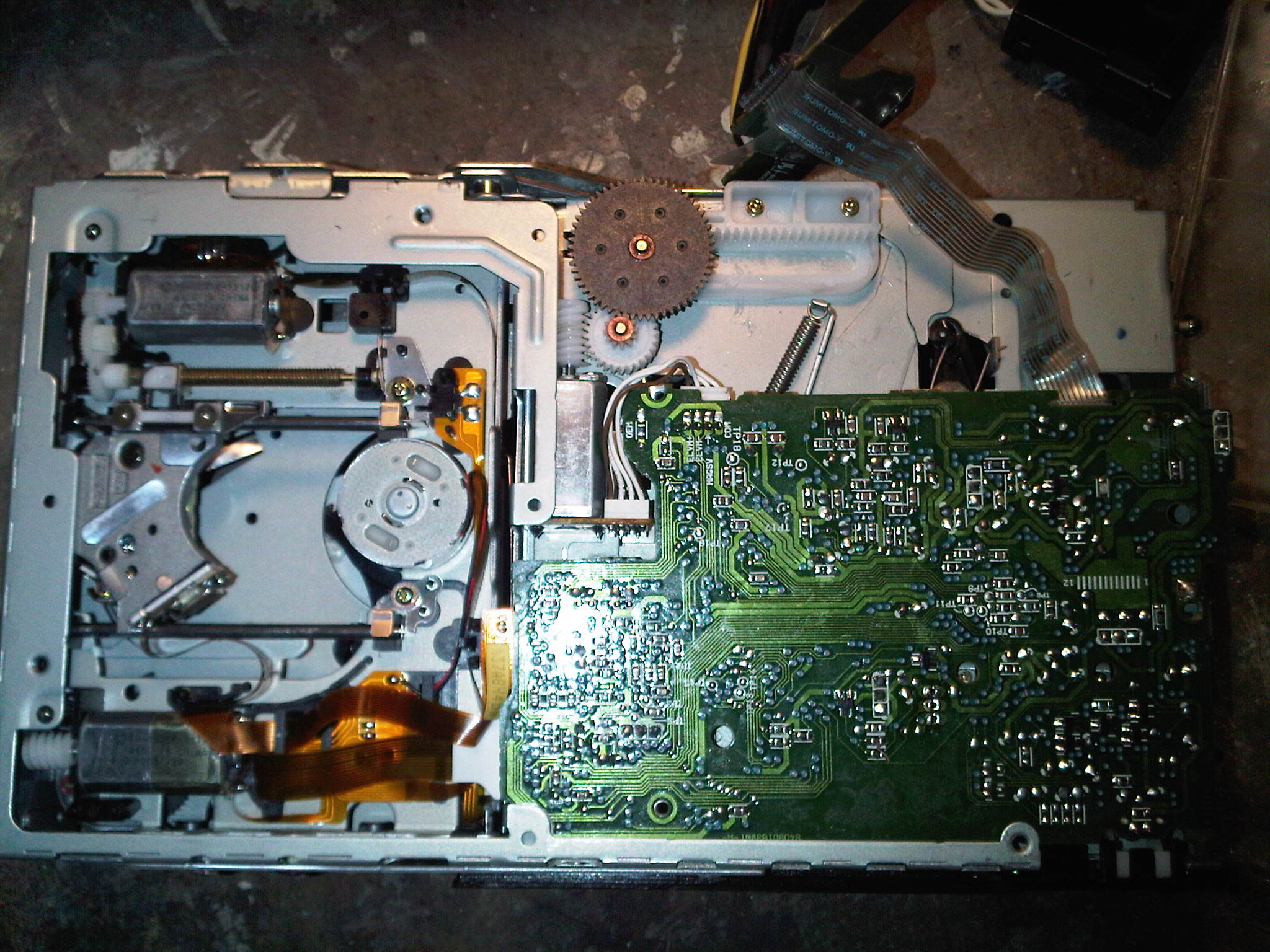

I have a CD changer in my 1995 Mercedes E320 which has given me problems. While taking it apart, I forgot to remove a couple of screws and broke the end off a switch which indicates that the cartridge has been loaded. I can't repair it so I need to replace it. I believe the changer was made for Mercedes by Alpine. I have searched the web and found lots of photos of similar changers and they all seem to be essentially the same, so I'm hoping the part I need won't be too difficult to obtain. I have attached 3 images. One shows the overall changer; the second shows the part (circled) that I broke in the location it's supposed to be; the third shows the part mounted on the circuit board. The switch has a number "719E" printed on it. It goes onto the circuit board in the VR101 location. Can anyone help me identify what the part is called so that I can search for a replacement? Or if you know where I can get the part that would be even better. Thanks for your help. Bob

That actually looks like a slide potentiometer (VR101 = "variable resistor 101"?); I would desolder it, measure the resistance range, then -carefully- measure it (both in imperial and metric units - H x W x L) - then head over to DigiKey/Mouser and look it up...
It's probably common.

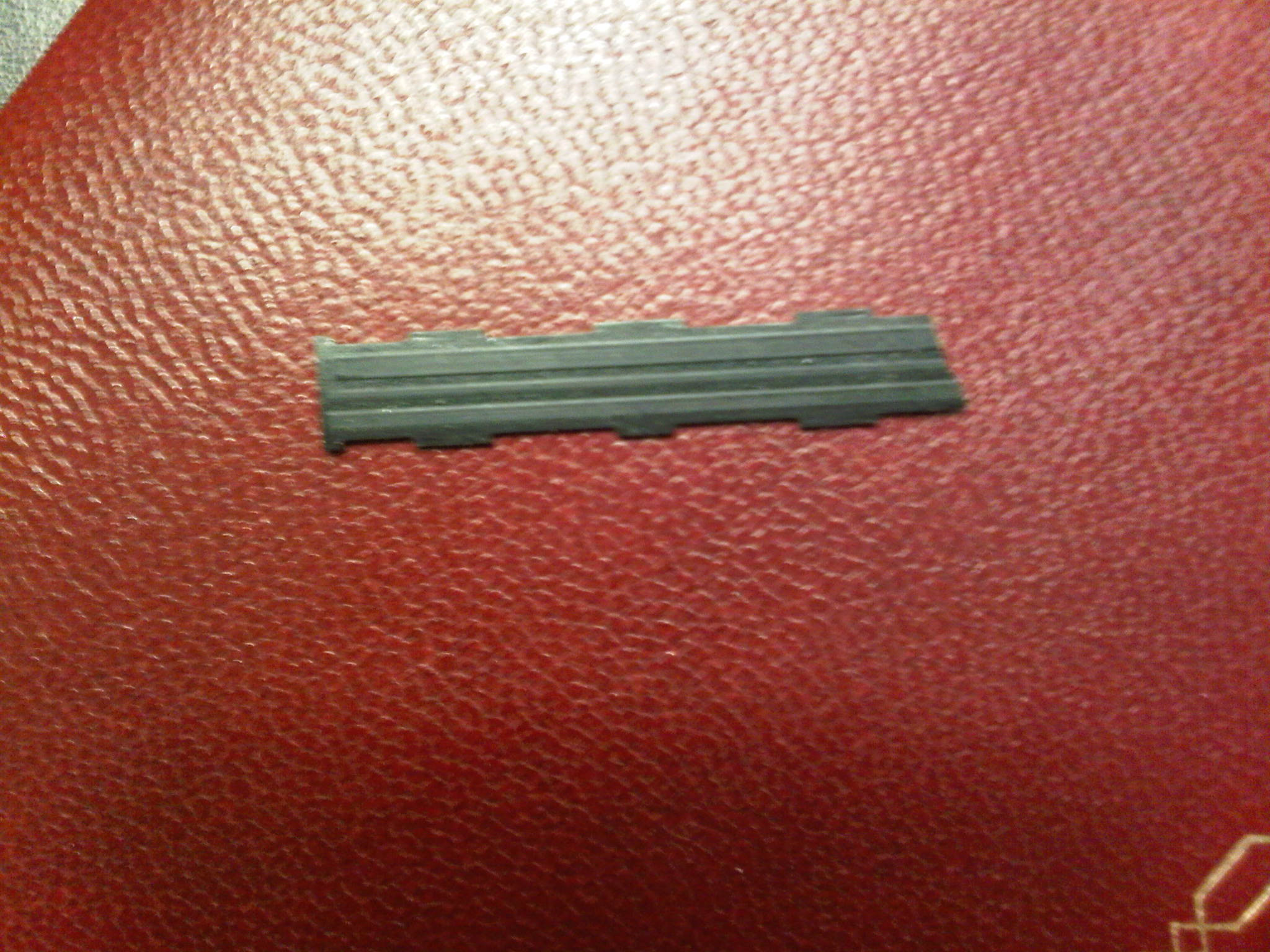

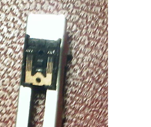

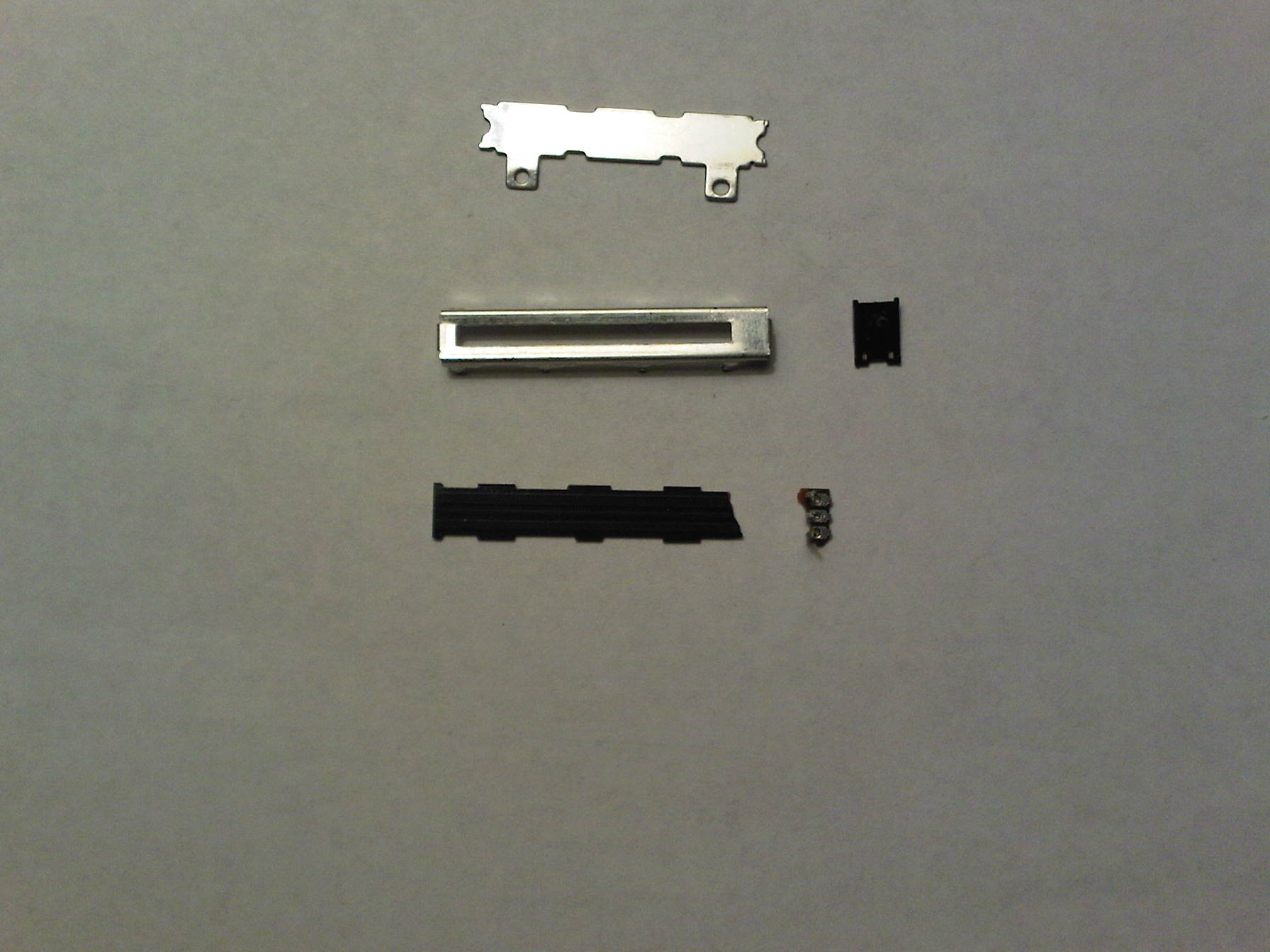

I've attached 3 images. The first shows all the parts - the cover, the resistance strip, the slider, and the broken pin section. The second shows the resistance strip. It may be difficult to see, but their are two wide sections on either edge and a thin section in the middle. The thin section is attached on the left side to the upper thick section. The third shows the bottom of the slider. Hope that helps. Thanks again for all your advice. Sorry if the photos aren't as clear as they should be. I'm using my Blackberry and don't have a camera with me. Bob

Probably the middle black line is the "zero resistance" rail, while the other two are "half-resistance" rails; you should be able to measure them by touching your multimeter leads to the end of each one; likely, the top and the bottom rails will have the same resistance, while the middle rail should be zero or near zero. However it works out, two of the rails will be the same or near the same, while one of the rails should be near zero. The value of the potentiometer then should be the value of the two rails with resistance added together (this is really assuming that the potentiometer is linear, of course - which is likely is for this application). BTW - there were no markings on the outside of the potentiometer? Most of time it is stamped or inked on (not always, though)...
It was hard to get a steady reading on two of the rails. One of the outer ones reads 0 while the other is 10KΩ. The middle one (it's attached to the 10K one at the bottom) reads 600Ω. I've tried three ohmeters and get the same results on all of them. By the way the number stamped on the cover was 719E.
I'm going to guess its a 10KΩ potentiometer; I base that on what I can see in the pics, which seems to show that there isn't a "center wiper" (there are two outer ones, though - at least what I see in the 3rd pic). The three pins on the potentiometer - how do they appear to be connected on the PCB (when they were connected, that is); do all three have traces which connect to another component on the board, or do only two? I am trying to determine if the device is being used as a rheostat for current or as a voltage divider. Maybe you can look on Mouser/Digikey and see if you find anything like a "10KΩ w/ 600Ω limiting resistor" or something...?

I have another idea for you. Measure end to end for the top, middle and bottom slider.
Three connections bother me a bit. I can't figure out how 3 connections would be made. The end to end resistance of the top and bottom rails COULD make up 1/2 the value of the potentiometer.
Also wondering if you could tell anything with the slider taped to the resistive element. There is something I'm missing.
