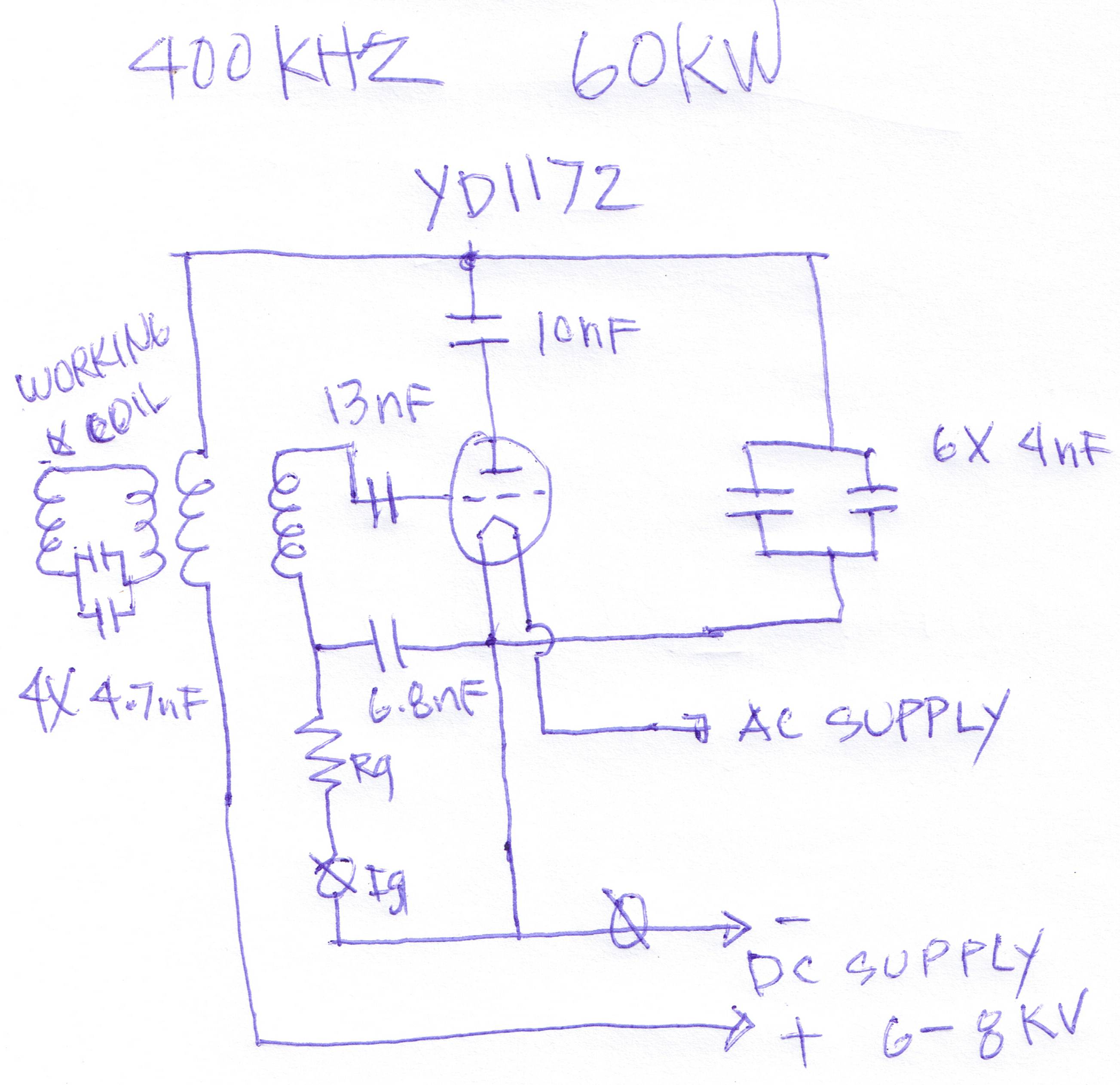

Here's my circuit. Can somebody give me a much more simpler than this. Says 2.5kw
Thanks in advance

To expand on what is wrong with the circuit:
The anode voltage is rated at 7.2 kV maximum, so 6 to 8 kV will not do.
The thing which I assume to be your cathode current meter is likely to be fried by the 130amp filament current.
There are no DC paths to either the anode or the grid.
As drawn, it is not going to work.
