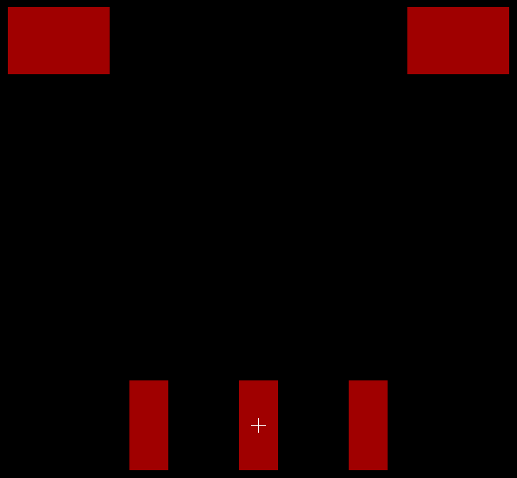

Hi rs14,
I tried to create a package for your switch. I used the datasheet provided at Digikey and referred to page6 for the SMT footprint.
There are some slight discrepances in dimensional values converting from inches to mm. I used the inch based numbers up to 1/1000" accuracy.
Please print the footprint and check if it matches the switch you are using. I will then finish the design for an entire Eagle device.

Yeah I actually watched a tutorial on how to make the part on Eagle, and from your image, ours look very similar but I will add yours to my library just to see how close we got. Thanks for going out your way to do that!

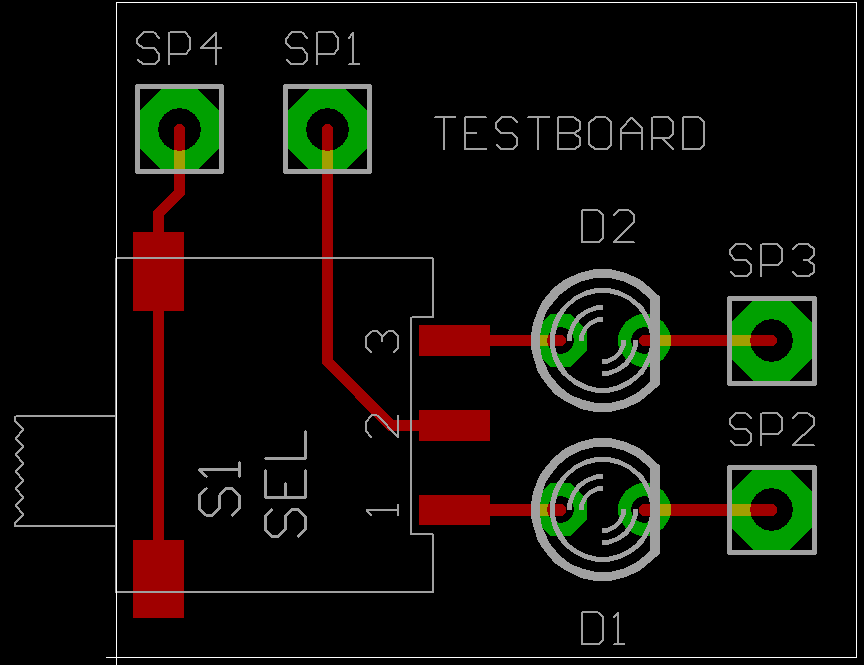

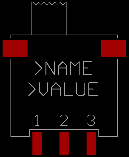

Hi rs14,
here is the entire device for your switch. I guess I'll have use for it as well since it is really small.
I connected the solder pads at the front end to pins. Connecting those pins to circuit ground might be useful when switching high frequencies, since the switch seems to be completely metal encapsuled.
When dropping the switch onto a schematic activate the pins layer. You'll see two unnamed pins seeming to go nowhere. They are in fact connected to those mentioned solder pads.
You will see the package outline as posted if layer51 is activated. After deactivating it there won't be any annoying contour lines across the SMD pads. (Layer51 is never used in board houses.)
The test board connects OK.

I noticed from your schematic file that you are using the wrong symbol type I think. You have pins 1, 2, and 3, but for the ES02MSABE, they only use pins 1 and 3 in the schematic symbol. I'm still new to part making so if I'm wrong, let me know why they have it drawn like that in the schematic. I have attached the image for your convenience.

Oh nevermind, I see now. You did not know which one I was making from the 3 types, but that is fine. I am using the ES02, but I should be able to edit your library file to tweak the pins and the schematic drawing. You did an awesome job on the board drawing!

Hi rs14,
I assumed you will use a SPDT for your project, which provides the option to position the switch either on the LH or RH side of the PCB to power up the circuit by pushing the switch (moving the slider upwards).
According to the pad layout the SPDT symbol won't fit since the SPST switch closes terminals 1 and 3.
I will add that switch in the library and post it here.
Removing one solder pad and adding a new symbol is a matter of minutes.

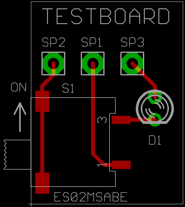

Yeah for my application, I just needed an On-Off switch. I think the other one's are On-On switches.
Not quite. The SPDT switch is a three position switch with the center position OFF.
Anyway, here is a testboard and the revised zip file. Have fun!
