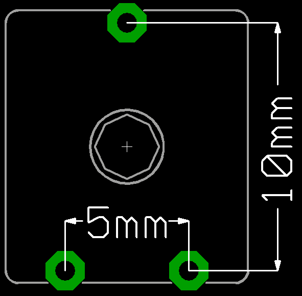

danrogers Member Mar 21, 2010 #1 Hi there, I'm using a finger adjust potentiometer in my project but cant find anying similar in Eagle **broken link removed** Dimensions 9.8 x 11 x 6mm Pitch 5 x 10mm Please let me know if you have come across anything similar. It also states the following in the description.... •Pin positions compatible with Piher PT10 and Citec CT10 series •Iskra PNZ10ZA series But they dont appear to be featured in the libraries either Thanks

danrogers Member Mar 21, 2010 #2 problem may be solved, im not sure yet untill I get to a printer. Found a CA9V from Schukat that looks like it may have the right pin spacing

Boncuk New Member Mar 21, 2010 #3 Hi Dan, if the pin spacing is 10/5mm you won't have trouble using any pot. The ISKRA you mentioned has a height of 11mm and a width of 9.8mm Here is the ISKRA pot. I "converted" the axle from hex to octagon - with no effect on the circuit. Boncuk Attachments ISKRA..gif 8.3 KB · Views: 626
