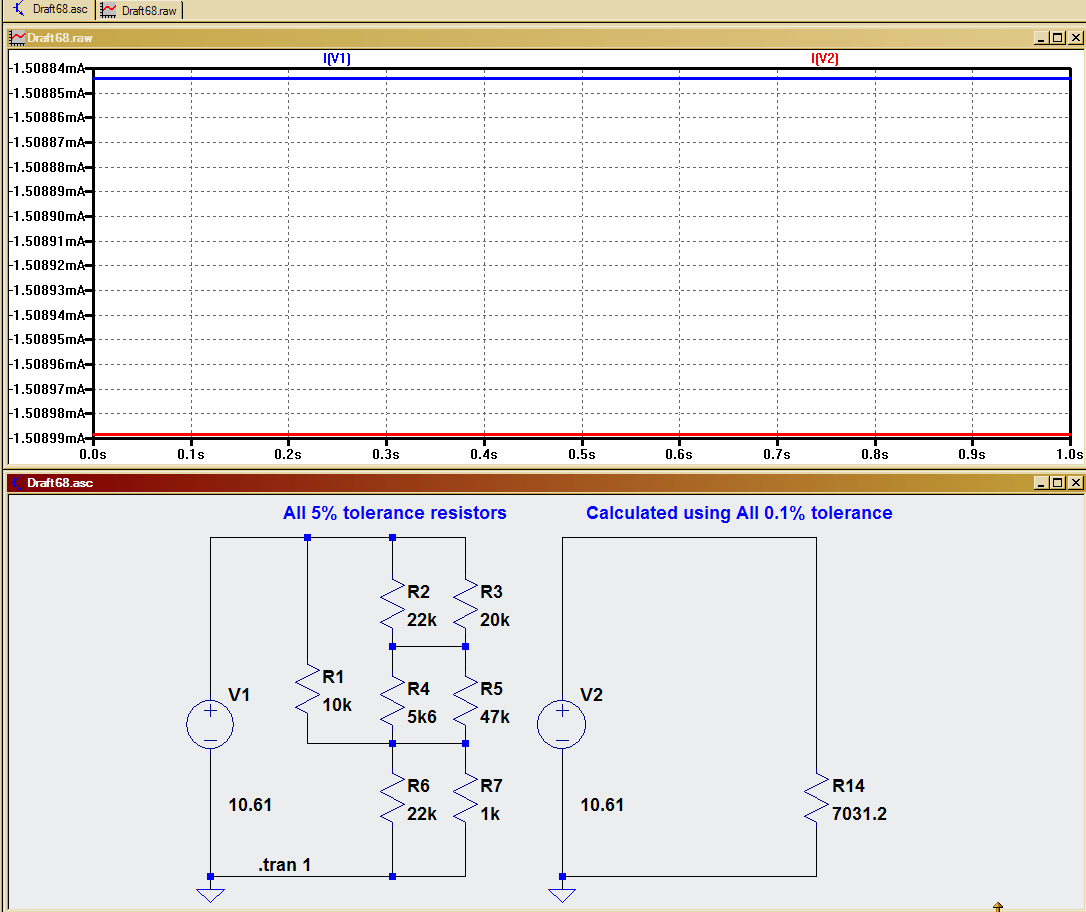

LTspice indicates why there is a difference.

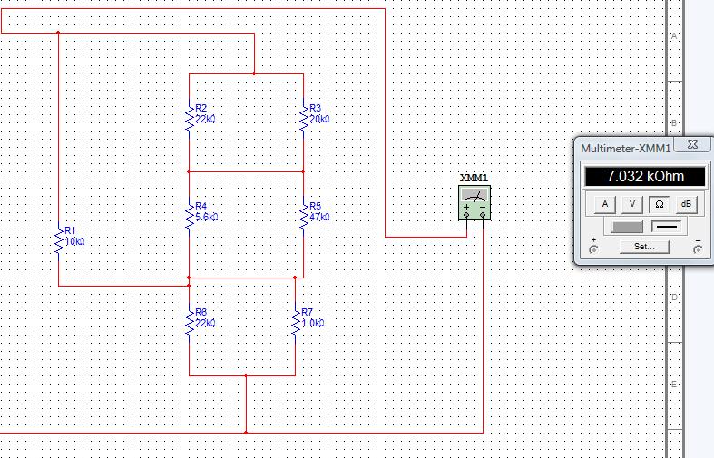

Sorry sir but I don't understand.. ? where is there a differance and why :\
The LTS 7031R value is very close to the multisims 7026R, sims use more precise calculations than we do.
Your answer of 6350R is incorrect, try to redo the sums.
Well my answer has to be correct because when we did the lab, all my values were good.
And before doing it with real resistors, we had calculated 6.35k.
What is LTspice ?
I just run it in multisim 8, and I get 7032 Ohms, which I believe is as good as identical to ericgibbs result with LTS

Try redo-ing your calculations. Your equation in your first post seems to be correct. I plugged the values in and worked it out on a calculator. My answer is 7.032k.

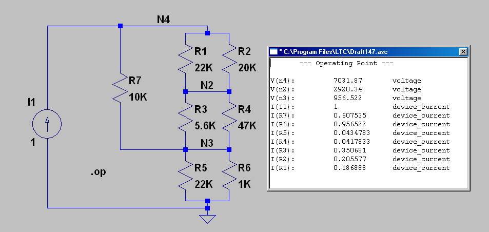

LTSpice is the best free circuit simulator available on the web; better than ones that charge $20000
I put the network into LTSpice, and force 1Adc through the network. Since the voltage at Node 4 is 7031.87V, then it follows that the equivalent resistance from N4 to GND is 7031.87V/1A = 7031.87Ω

but, software aside, on paper with a pen and a calculator... how would you approach the config eq for the Rt ?
I see it as (((R1//R2)+(R3//R4))//R7)+(R5//R6) but I can be wrong ?
With my "paper & pen" (actually excel spreadsheet) it is 7031.87384179803Ω using your equation, which is correct. It's all about the number of decimal places used.

Step by step.....
R1 || R2 = 10476.2R
R3 || R4 = 5003.8R
R5 || R6 = 956.5R
10476.2R + 5003.8R = 15480R
So R7 || 15480R = 6075.4R
So 956.5R + 6075R = 7031.5R QED
That's weird because my 6.35k value was correct according to the teacher and my classmate. There's no way a decimal could cause a 682 ohms differance..
You really need to tell the teacher and your classmate that they are wrong. It would be interesting to see what the mistake was that each of you made.
Please throw me a log in the face.
R5 is actually 2.2k, not 22.
And I've spent hours on it because of that stupid mistake of mine. I was so ashamed and discouraged for nothing.
