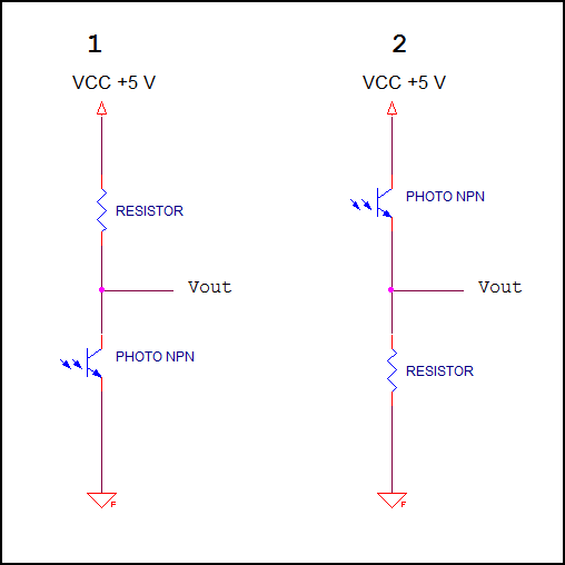

I don't get it? This is a link to your part's data sheet. With a VCE of 10 Volts the Dark Current is about 100 nA and with a VCE of 10 Volts the Typical light current should be about 1 mA so where is this 2 uA coming from? Can you post a circuit of just how this photo transistor is configured? You should (as mentioned) have a series resistor with it. Exactly how is this configured? You should have something that resembles the attached drawing.
Next, give this link a read. Scroll down to the Photocell Circuits on the linked page. Also read about comparators.
Using a phototransistor as you are doing you should not need a comparator.

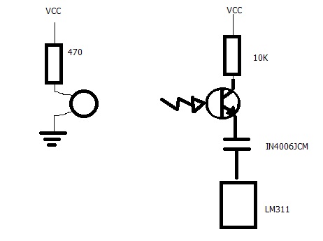

Ok I'll try to explain the circuit the best I can.
The IR led has a Resistor of 470Ω. The photo transistor has a 10K resistor in the VCC input and has a IN4006JCM in its output. If I measure the current in the output it gives me 2µA.
I attached an image ( not the best diagram) of the Led and phototransistor.
My circuit needs to do the following:
When the signal between the LED and the Phototransistor is interrupted, the other component I'm using (CPLD) to do a count. SO basically everytime the signal is interrupted, the CPLD will count so I know how many times was the signal interrupted.

mif987 absolutely dont need any comparators and messing with currents but only voltages! you ned to make a pull up resistor to get what you want
Do what Steven87 has said. Make your receiver like the drawing I posted #1 of the two and use 10 K for the collector resistor. Take your output at the collector as I drew it. The drawing you posted makes no sense and won't work.
