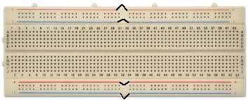

One thing occurred to me , The BB doesn't have a split power rails ( half way ) check each side the red paint ...
Look a this image.
Links in Black.

A good suggestion, but this is not the problem.
I've just checked, and there is full continuity along both rails that are in use, +5 and ground. I've drawn one red (for +5 volt rail) and black line (for ground rail) to show what pins on the rails are actually verified to have continuity.

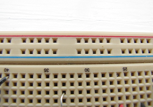

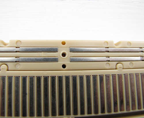

The BB looks exactly the same make as the one I have in my photos it has no connection between holes 32 - 34 on the + and - rails both sides . did you take out all the +- wires to test it ? could be paths through the chip , 100mA is going somewhere Is the BB back visible ?
I truly wish the problem was as simple as this.
I've checked once without removing all the wires, then just to make sure I checked with removing all wires as well after I read your comment.
I tested every single hole on both rails, everything is connected to everything. I especially tested holes 32 - 34 extra thoroughly, I also got a tone on everything from 1 to 63 on both rails.
It seems your BB has a slightly wider gap between hole 34 and 35. The line should be broken there to make it clear and intuitive, but my BB has no such wider gap, everything is connected.

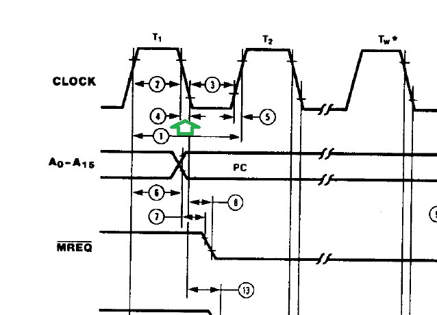

Hi HE . Frequency is not the question , your CMOS Z84C0020 will go from DC to 20Mhz , I question the oscillator you have is not providing fast rise and fall times ( green arrow 4 also 5 ) I dont have timings for 20Mhz chip but 10M is 10ns ... your transistors need a logic gate like 74HC14 ... Or use a 4093 as in original circuit...
Good suggestion, thank you. I will try something else.

Hi granddad,
I think you have the solution to the problem with the rise time of the clock waveform. I did an experiment by slowing the edges of the clock waveform down with a CR network. The circuit worked with a rise time of up to about 300 nS but stopped working with any more than that. (I only tried with one of the CPUs) I thought that the OP had originally built the circuit to the diagram. The picture of the clock waveform in post #1 of this thread shows the slow edges. Even with the rise time slowed down to about 3 uS the slope is not visible when showing a full cycle of the waveform.
