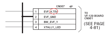

I have a small CRT display and driver board that I have extracted from a broken camcorder. The driver board requires 4.75 volts DC for power. I don't have any way of providing this voltage from batteries, so I need a voltage regulator, or converter or a transformer that will output 4.75 volts. I would prefer that the input voltage of the converter/regulator be 12 VDC, but a lower or higher voltage is acceptable. Any help is appreciated.

I have the service manual for the camcorder, which has diagrams of all the circuits. It shows the voltage on the cable supplying power to the board as being 4.75 volts. (see attached image)

It's probably designed for a nominal voltage of 5V, 4.75 is 5 - 5%.
If you've measured 4.75V it's because the PSU is on the bottom end of the tolerance band.
The chances are your CRT will work fine from 4.5V to 5.5V.
I would recommend six NiMH AA cells plus a 5V low dropout regulator.

The circuit diagrams in the service manual said that the input on the CRT driver board is 4.75V. I was unable to measure what the actual voltage was because most of the camcorder had to be disassembled in order to get to the CRT and it's board. As for the current, I'm not sure, I haven't measure that yet. Thank you for your help.
