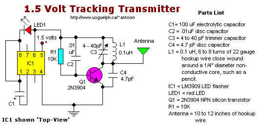

The very cheap and simple project is here: **broken link removed**
It uses an obsolete LM3909 iC that you won't find anywhere.
Its range is 30 feet but its frequency changes all over the place if anything moves toward its antenna or moves away.
You need a huge directional antenna on a very sensitive FM radio to track it.

That very cheap and simply project seems like what Im looking for, but im not sure it would be practical with a range of only 30 feet. I had planned on buying a scanner as a reciever instead of using a conventional FM radio....would that help?
You don't want to use that cheap circuit. You need a circuit that doesn't change its frequency all over the place. You also need a more powerful circuit.
But how are you going to track the direction of the radio transmitter? A directional antenna is huge unless it uses a micro-wave frequency.

I know that the scanner wont give me a direction like a pointer or anything, but I was thinking it would work like a homing beacon, where the closer to the transmitter the faster the beeping noise....
The oscillator in the transmitter makes the speed of the beeps. The distance of the receiver has nothing to do with it.
If you use FM then the loudness of the beeps is the same when the signal is extremely strong and when the signal is very weak. An FM radio with poor sensitivity might produce a difference in volume but will not be sensitive.
If you use AM then the automatic-gain-control in the radio makes the loudness of the beeps the same when the signal is extremely strong and when it is very weak.
EDIT: The very simple tracking transmitter does not transmit beeps. It simply turns itself on and off and the radio produces "inter-station hiss" when it is turned off so the hiss turns on and off.
if the radio has muting then there won't be any hiss.

You might be able to have a transmitter and design and make a receiver that measures the signal strength and makes the beeps quicker when the signal is strong and makes the beeps slower when the signal is weak. You would need to move the receiver pretty far to make any difference in the beeps. But you won't know the direction until you pick the correct direction or pick one of the many incorrect directions.
