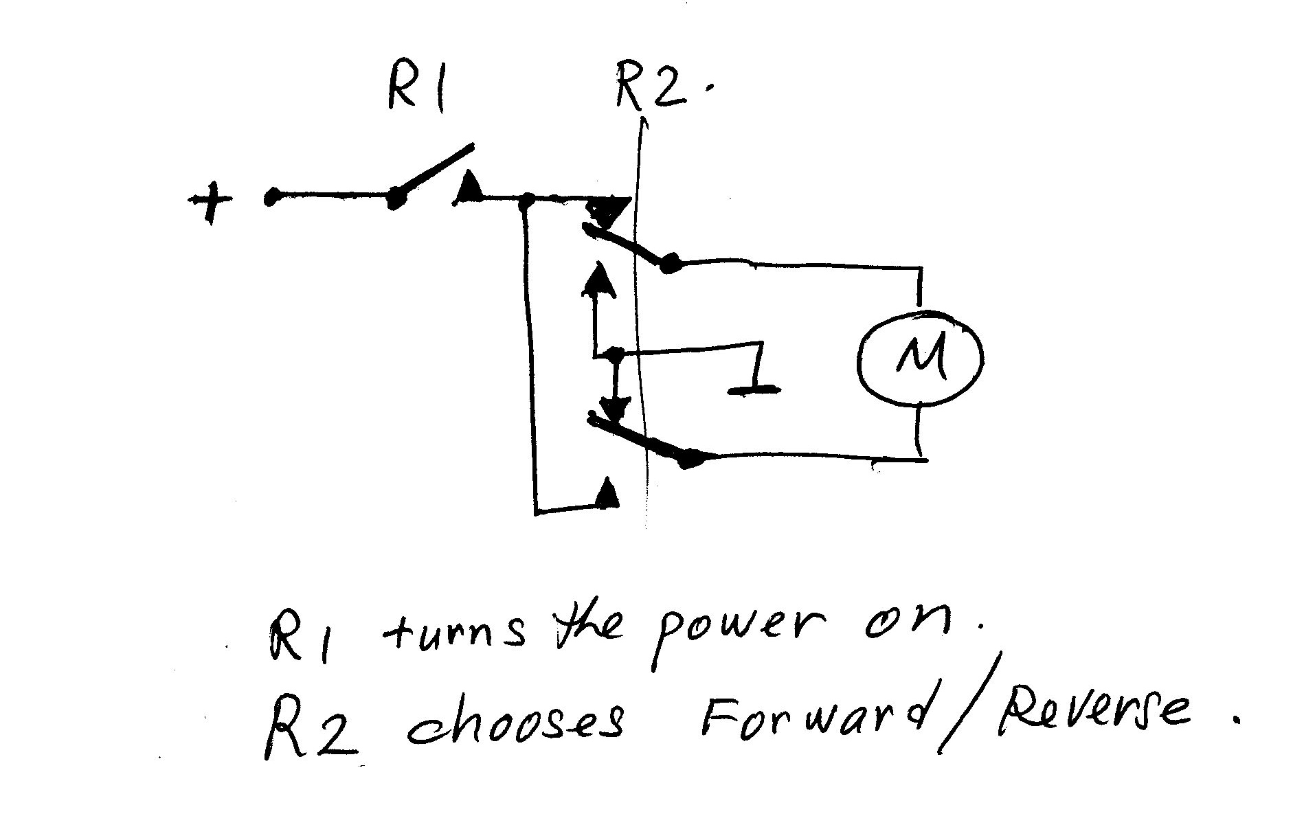

need h bridge circuit using relays??
I would do it with 2 relays, not 4.
