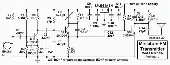

Hi Marks, look in the projects section of this forum for audioguru's FM transmitter, it has a 2n3904 amplifier that amplifies signals at 100MHZ (its the transistor furthest to the right on the schematic). What frequency are you trying to jam? and could I see your circuit? sounds interesting.

Also, i looked at that circuit, but it didn't have any 3904's in it, just 2222's??
The fundamental frequency of a 555 timer goes up to only about 1MHz which is in the middle of the AM broadcast band.. Its harmonics go much higher but are reduced in amplitude. I doubt that the harmonics would interfere with an FM radio at 100MHz.
My FM transmitter uses 2N3904 transistors that are about the same as 2N2222, BC547 and many other general purpose transistors.

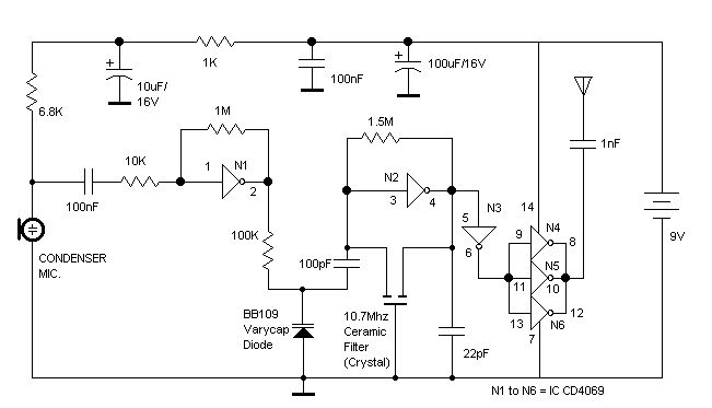

It is the fast edges of the output from the hex inverter that creates harmonics up to the FM broadcast band. The output of a 555 timer is too slow by itself.
So the hex inverter is the only reason it worked?
Yeah. A Cmos hex inverter is used as an FM transmitter where its 9th harmonic of a 10.7MHz oscillator is at 96.3MHz:

Oh, i see. If you hook up more than one inverter in a parallel, then you will get more output? Also, what is that symbol for the "crystal", is that a 2 pin crystal, with the can grounded, or is it a crystal oscillator(the 4 pin thingy)?

The output current of a Cmos inverter is low. Connecting 3 in parallel provides 3 times the output current.
It has 3 pins (input, output and ground) and it is clearly labelled as a 10.7MHz ceramic filter that is something like a crystal. It is used in FM radios.
