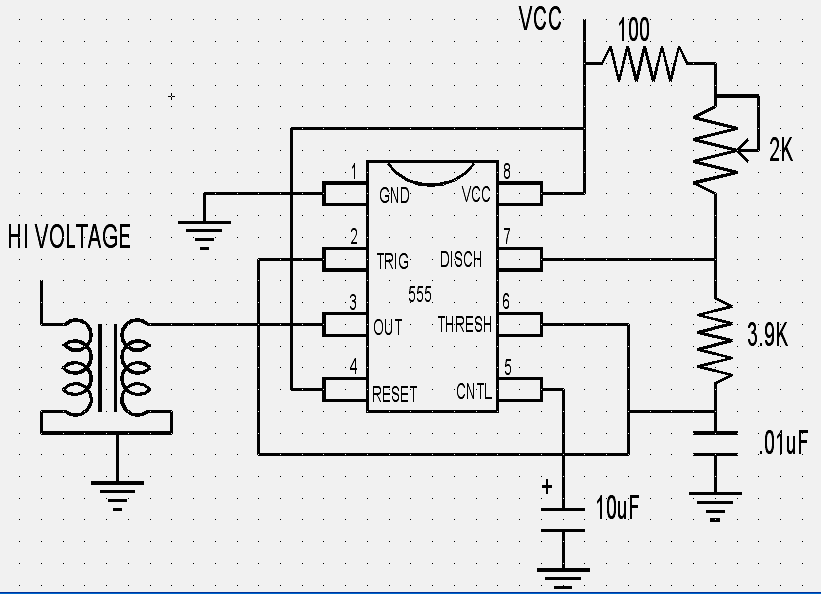

I am having trouble comming up with an adjustable timer circuit that will osc at 15Khz. Well the biggest problem is the math for the RC. 50% duty cycle. It has been years that I have messed with these 555's and can't remember the math.
I will try to discribe what I already have:
Pin 1 - Gnd
Pin 2 - 6
Pin 4 & 8 to plus voltage = VCC?
a 2.2K from Pin 7 to Pin 6
Pin 3 to a 22 ohm resistor with a 10K pull down resistor to ground driving the gate of a IRF740 MOSFET. Source to ground, Drain to an automotive 12V ignition coil.
Now from the adjustable power supply, (26VAC output, 110VAC input hooked to a fan speed control so to vary the trans output voltage). There is a full wave bridge and cap (220uF 50V) on the output of trans. 2 - 2K 1/2Watt resistors (1K) on the plus side to my 555. Now to vary the frequency a bit.
If I hook up a 2K pot from vcc to pin 7 what will I need for R Total?
There is also a 10uF cap on pin 5. There may be other parts of this circuit I don't need, so I guess what I am trying to do is vary the high voltage from the ignition coil from 6KV to say 10KV at 12Khz to 15Khz.
The circuit I have varies the output of a flyback transformer. I just need to make it work on an ignition coil.
I will stay tuned tomorrow for more info if needed.
Thanks.

Hello.
In some tests I've made, the ignition coils that use ferrosilicon plates core have an maximun oscillation response of about 4 kHz ~5kHz.
Look for a 555 Astable circuit to make the oscillator.
26V is too much, you'll burn the power transistors/mosfets.
I've burnt 3 paralleled 2N3055 with a 28V supply.
Try a lower voltage like 15V.
Hope this helps:
The ignition coil is a flyback transformer.

Ok, the 555 astable is given by R1, R2 and C1;
As you said:
VCC --- R1 --- PIN 7 --- R2 --- PIN 2 + 6 --- C1 --- GND.
Formulaes:
R1 and R2 = Ohms;
C1 = Farads;
T = seconds;
f = Hz;
T(high) = 0.696*(R1+R2)*C1
T(low) = 0.696*R2*C1
f = 1 / (T(high)+T(low));
f = 1.44 / ((R1+2*R2)*C1);
Duty Cycle must be different from 50%.
The main problem of this configuration is that the duty cycle is not fixed when you use a potentiometer to change de frequency.

If you have R1 = 2900 Ohms and R2 = 2200 Ohms and C1 = 0.01uF
f = 1.44 / ((R1+2R2)*C1)
f = 1.44 / ((2900 + 2*2200)*10x10^-9)
f = 1.44 / ((7300)*10x10^-9)
f = 1.44 / (73000x10^-9)
f = ~ 1.97 x 10^-5 x 10^9
f = ~ 1.97 x 10^4 Hz
f = ~ 19.7 x 10^3 Hz =~ 19.7 kHz

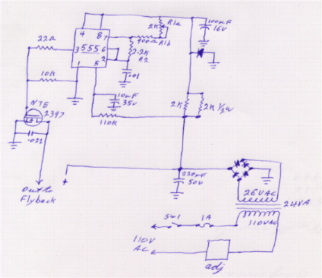

Well here we go.. attached is what I am working with. It uses a flyback to get the high voltage needed to produce ozone, 5KV approx at lowest setting.
As you can see it uses a motor speed control to change the output of the step down transformer. The 2k pot once set is not touched. By changing the values of R1 and R2, can we make this circuit get the same results by using an ignition coil instead of the flyback? I am thinking the mosfet won't handle the curent needed to get the ign. coil fired and there is not enough from the transformer to do the trick either.
This unit draws less than 1 amp. But will the ign. coil work?
hope i can attach a file. it is freehand but i think it will give you an idea what i am trying to do..
