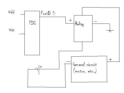

From the code I can see it uses PORTB 0 as PWM output. In my theory if the relay doesn't need much current for actuation I wold do this:
circuit-jpg.11816
Excuse me I just did that drawing in paint. It's just for the ideea.

Yes, you need a schematic first. Get that and we can go from there.
What kind of relay is that? The pic will probably not handle a coil directly. Maybe drive a transistor and make sure you have current limiting on it and a diode across the coil.
He wants to activate the relay with full power then back off the power to hold the relay energized at a lower current.
A microcontroller making PWM is a little more efficient than using a coupling capacitor to provide full power in parallel with a resistor that reduces the current.
Yes audioguru. that's exactly what I need...by using a resistor the power is still lost thorough heat dissipation in the resistor...I just need to reduce the overall power consumption of the whole circuit.
Now I am in the phase of designing the schematic for the circuit. Probably the asm for the pic is ok so I don't have to worry right now about generating the PWM. I don't know if I can drive the coils of the relays directly from the pic. I probably need some transistors or something...
Look at the spec's on the datasheet for the microcontroller. The max output current is 25ma per output and the voltage drops with that much current. You need a transistor to drive each relay.

I can choose any relay I want, it's not a given model. That's why maybe if I could find those that have an input voltage <5 and low current need, I could connect them directly to the port of the PIC. And one more thing I did not think about is the Z (impedance) of the coil since in my project I am not using DC current and from what I know a coil has different resistance at different frequency. Thank you Luis for noticing that. Thanks to all of you helping me!
Aren't we forgetting that the relay coil, as an inductor, will dump its field energy through the diode across it (assuming there is one), thus dissipating the energy there instead of through a resistor?
If there isn't a diode to dump that energy, my guess is that the coil inductance will stabilise current flow to a reasonably constant value, which will have exactly the same effect as using a resistance to control current - in this case the switching device (transistor) will drop a constant voltage also, and dissipate the exact same power that a current limiting resistor would.
I reckon that you can't significantly reduce power loss in a relay by using PWM, due to its high inductance.
However - you might be able to harness that field-breakdown energy with a second winding on the relay core, or some clever buck-style energy pump/reservoir circuit instead of a simple diode across the coil.
