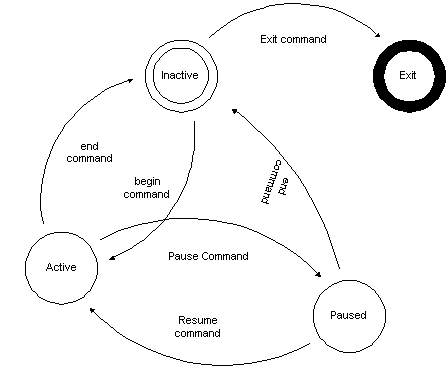

If you can define your problem in a state diagram, you've half of your problem resolved.
See the following sample image:
Since most likely it will be a very simple diagram, you may not require to perform Karnaugh mapping.
Yes, the posting #4 seems to have the sequence correct.
Im sorry Shmidt Trigger...I don't have the intelligence to follow your diagram correctly.

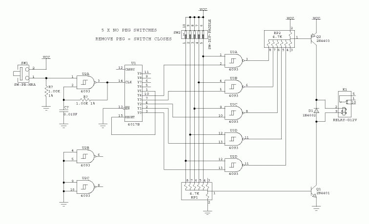

Here is my first pass. It will run on anything from 5 to 15 V. From deep in my sordid past, I like using resistor networks as combination gates. RP1/Q1 function as a 5-input NOR gate; if any input goes high, the output goes low, and makes up 1/2 of the relay power circuit. RP2/Q2 acts as a 5-input NAND; if any input goes low, the output goes high, and completes the relay power circuit. U2A is the oscillator, running over 100 kHz for as long as the button is pushed; should be random enough.
Note - parts are from my design library to show the concepts, and are not critical. There is no need for 1% tolerance resistors, or that specific relay. I used a DIP-switch package to emulate the five peg switches or sensors. I think microswitches will give you the least grief.
ak
Note: No Karnaugh maps were created or destroyed in the process of this design.

Analogue...Holy Bat-S&%$! that's beautiful. A elegant, yet simple design. I may be pushing the freebees, but can you redraw it using opto emitters/detectors instead of the switches.
I thank everyone for there input, and I really thank Analog for taking the time and skill to do this...ABSOLUTELY BRILLIANT!
